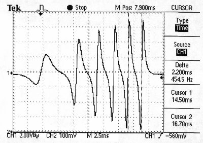

Transit time vs opening time. If you use GGDT, most barrels have most acceleration in the first 1/3 of the transit time. Getting the valve open in this first 1/3 makes a lot of difference. This is the primary reason our team did not use a ball valve for the t shirt launcher competition.

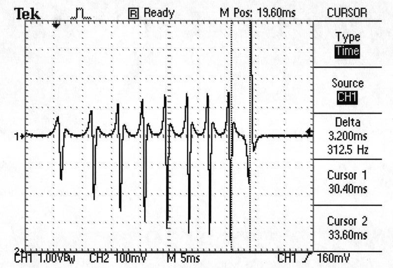

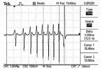

Our design goal was for a valve with under 5 ms. We appear to have faster than 2 ms.
- T Shirt launch test data, position and time. Blips are 1 foot of shirt travel in the barrel.
Dotted graph is 5ms per square on the horizontal direction.
The last foot measured with the cursors took 3.2 ms to travel for an average speed of 312 FPS. The height of the blips is roughly in direct proportion the speed the magnet in the shirt crossed the coil.
Last edited by Technician1002 on Sat Jul 04, 2009 6:47 pm, edited 2 times in total.

Most of the info including pictures of the setup are posted on the official contest website. The blips are generated by passing a magnet though a coil of wire. The barrel has coils of wire carefully spaced 1 foot apart starting at the muzzle. The first coil is near the initial position but is not at the zero position. Working backwards, each foot of travel can be measured for time. The curve as the magnet passes through is an S shape. The middle of the S where the voltage crosses zero is the precise point where the magnet is neither entering or leaving the coil and is a tight indicator of the precise center of the coil.boyntonstu wrote:Thanks for your responses.

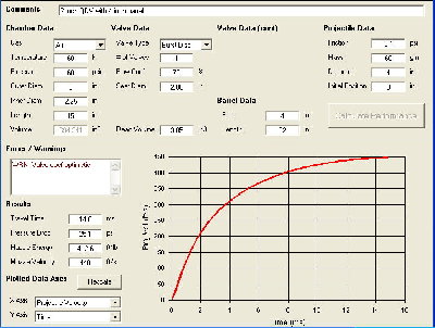

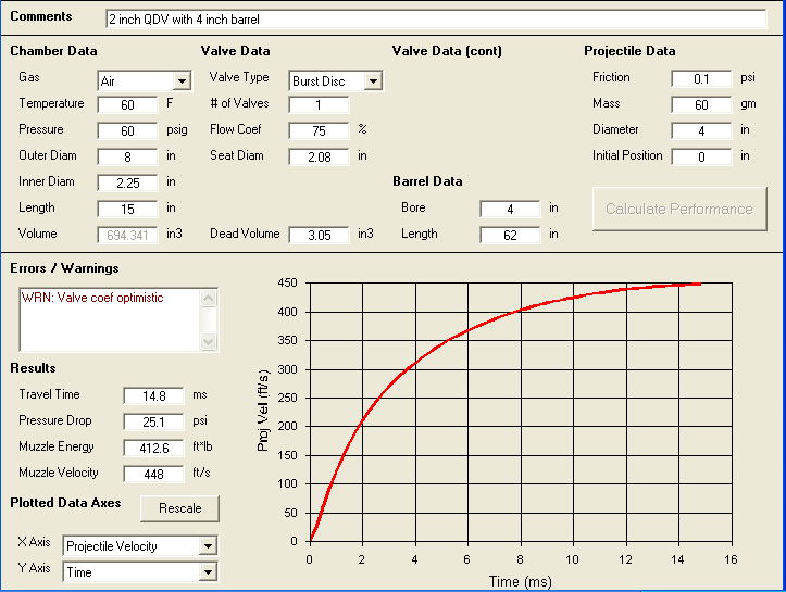

Taking time measurements for each foot and working backwards we can create an acceleration graph using the change in velocity as acceleration. Using that we were able to tell at what length we were no longer accelerating much and gave us the optimum barrel length to match the COF of our valve and volume of our tank. Looking at the early acceleration of light objects (4 inch foam ball) we got a good indication that the valve opening time is under 2 ms. Acceleration drops after the first foot and not still increasing from a valve still opening. Acceleration in the first measured foot is the highest and only possible with a fast valve.
We used this data to find the best length and decide between a 2.5 or 3 inch barrel. Even with a 2 inch valve the 3 inch barrel was a better choice for speed. We predicted higher speed from the 2.5 inch.
COF is how well a flow passes through a valve when it is open. Big flow when open counts. A fast QEV for example may only be able to supply enough flow to get the foam ball up to 250FPS, even though it can open faster than a piston. A fast enough piston and high COF is a winning combination.

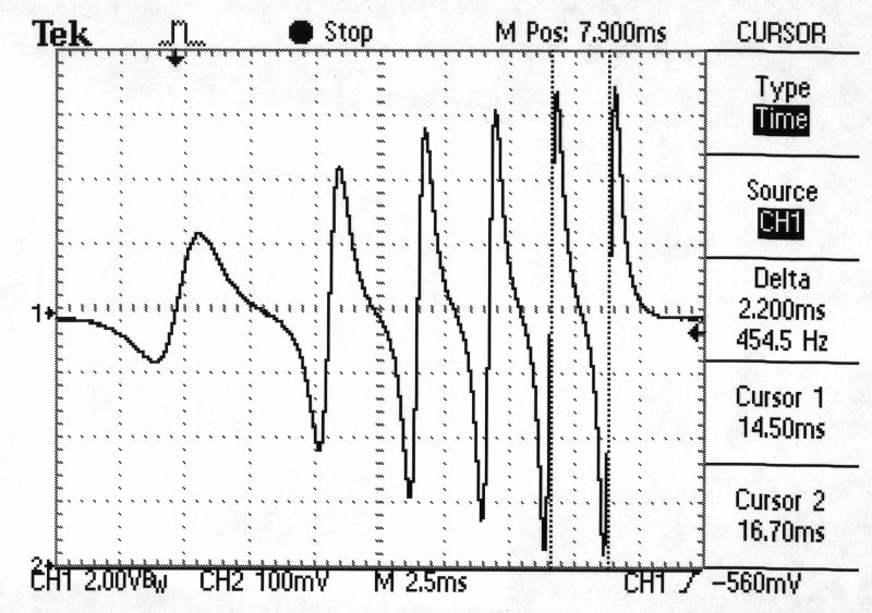

Attached is the 60 PSI shot of the 4 inch foam ball. Note the high acceleration early in the shot. Remember, this is a 2 inch valve feeding a 4 inch barrel. Plug in the values into GGDT. This graph is the one we used to find the COF is high. Lower COF valves simply won't achieve this speed. At the end it is still accelerating, but at a slower rate. Only a high COF can reach these launch speeds with a 4 inch barrel. 454 FPS and rising isn't bad on a 4 inch bore at only 60 PSI.
