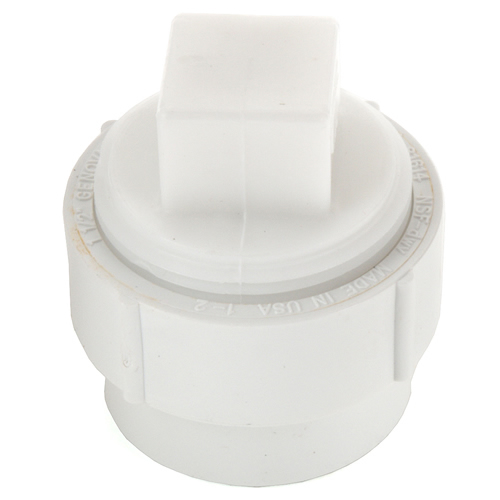

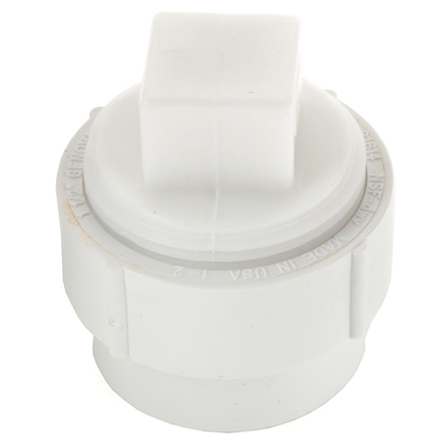

In the Cellular test cannon, for strength, it originally had a 2 inch schedule 40 female fitting and schedule 40 plug for strength. (they exist) It was brittle and the female fitting shattered on a shot. Good thing I was wearing good leather shoes. Bad bruise, but no cuts or broken toes.
In my experience cell core 4" PVC is OK for any propane combustion gun at 1X.
ABS doesn't have the tendency to shatter like PVC.
Went to a better bumper and an ABS clean out to fix it. It has not failed.
4 inch cleanouts do tend to blow off combustion cannons.
DWV PVC cleanout
DWV PVC cleanout
Schedule 40 pipe plug

Technician1002 wrote:In the Cellular test cannon, for strength, it originally had a 2 inch schedule 40 female fitting and schedule 40 plug for strength. (they exist) It was brittle and the female fitting shattered on a shot. Good thing I was wearing good leather shoes. Bad bruise, but no cuts or broken toes.
You mean of course that;
1) SCH 40 cleanouts exist, they are DWV only parts. The lower photo is a SCH 40 DWV cleanout.
2) In addition, there are SCH 40 pressure rated threaded components (the upper photo) that include threaded plugs.
I believe a "cleanout" is, by definition, a DWV only part since "cleanouts" aren't needed/used in PWS systems.
In other words, both of your photos are of SCH 40 parts. The lower one is a DWV cleanout and is not pressure rated. The upper one is a threaded fitting with plug that is pressure rated. Technically, the upper one isn't a "cleanout", though it could be used as one.
