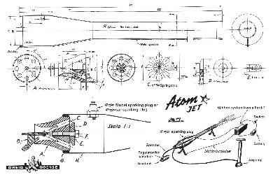

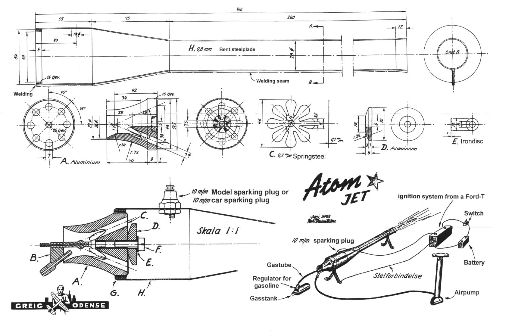

Any who. I've had this idea on my mind for many years when I was fiddling around with pulse jet engines.
So what are the things needed for an automatic combustion gun?
1.) A way to vent the chamber quickly and introduce more air with oxygen into it.
2.) Injecting fuel into the chamber quickly and precisely.
3.) Reloading.
2.) Well introducing the fuel into the chamber fast is no big problem. Using a fuel metering system with electronic valves to open and close at the right times. Or some sort of clock work thingy.
3.) Reloading is a bit trickier but I've seen a ton of different ideas and methods to reload, preferably one using a blow-back system

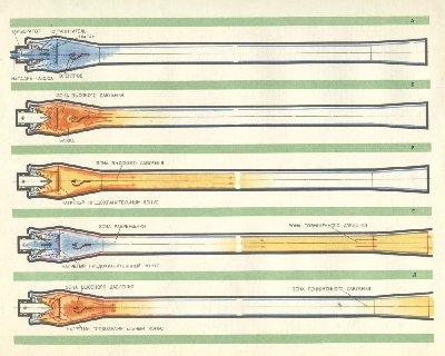

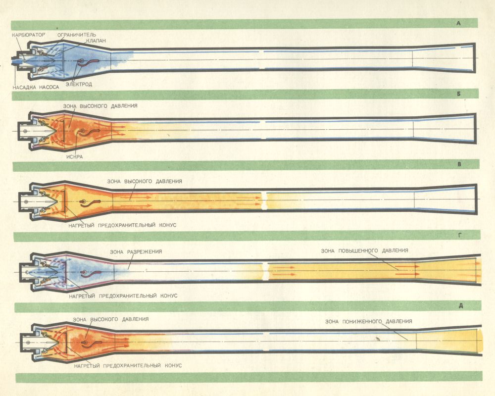

1.) The biggest problem is venting and recharging the chamber with fresh air. It could be done with some complex system of fans and blowers but it there would be significant lag time. SO! What I suggest is a Reed Valve.
~A reed valve works as a check valve. When there is a combustion in the chamber all the hot gasses escape through the barrel, creating a vaccuum in the chamber. This vacuumm will pull the reeds on the valve back and allow air to enter into it through the holes in the end cap or what ever you want. Then when pressure is normalized the reed valve will bend back to cover the holes and start all over again!.
~In pulse jets this happends thousands of times per second and will destroy the reeds in a matter of moments. Some of the hot gasses are pulled back down the barrel and, in a pulse jet, will ignite the constantly flowing fuel. Simply add the fuel metering system to prevent this chain reaction and use a circuit to deliver a spark after the fuel has been injected to fire again!
Thats my idea and it will be of more use to you guys than to me as of lately. I'll put up some images to help give you an idea but simply googling Pulse Jets and roaming around, you'll get the idea fast.
I hope this helped!! Please comment and tell me what you think....and say Hi XD

I've seen pulse jets.. Very noisy, very hot, and very inefficient. Loading something like a pulse jet where the acoustic wave refreshed the chamber air would be very difficult. Elsewhere I had some other thoughts on a full auto combustion, but it required powered venting/fueling as a proportioned mix on delivery. It would use a much slower repetition rate to permit gravity feeding gumballs for ammo. I'll have to hunt up links later.
The air and fuel are delivered at proportionate rates to the chamber and ignited. The backflash pressure interupts the fuel and air delivery so the source extinguishes the flow until the chamber returns to atm pressure where the process is repeated. Gravity fed ammo and a spark timer finishes the full auto design.
