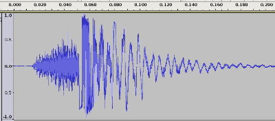

Small air cannon sound. Total time of trace is 0.2 seconds.  Recording is the Mouse Musket, a 1 inch coaxial about 30 inches long.
