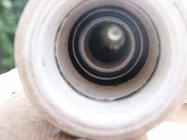

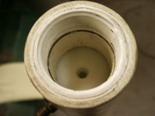

My Mouse Musket on a much smaller scale had the same filling problem as the fill is on the chamber and the piston did not use a spring. It's filling procedure was just a little different. The barrel was plugged and the chamber filled to a couple PSI. The plug was pulled. This sudden drop in the barrel sealed the piston. Then the chamber could be filled at any rate I wanted.

The EQ port was big enough to keep the pilot area above 25% of the chamber pressure during any fill I could shove through a tire valve. A close ratio (seat to OD) valve requires a very low pilot pressure to fire. In the case of the Mouse Musket, under 25% to fire.spudtyrrant wrote:well i see a problem with that solution tech if he filled the chamber fast enough after he close the valve with the 1psi(most pistons that large take more) and built up lets say 2psi the valve would open
A two inch piston at 1 PSI for example would have 3.14 lbs of force holding it closed. An area ratio of .75:1 would need the chamber pressure above 4 PSI while the pilot is at 1 PSI to fire. The small pilot area and eq port won't create the conditions required to fire on filling.
I filled it all the time this way. Plug the barrel, a quick shot of air, release the barrel and fill with full compressor flow. The Mouse Musket did not use o rings on the piston, but did use one on the valve seat. Moving friction is low.
