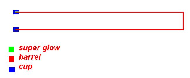

far_cry
Posts: 317
harder rubber also will be cut
you must make a bigger edge
or find something fits on the barrel edge and glow it
colty-bear
Posts: 250
Joined: Tue Feb 24, 2009 10:24 pm
that is going to be VERY hard the chamber is 5/8 and the barrel is 1/4 the barrel is about 2 inches in from where i can unscrew the trigger assembly

colty-bear wrote:the inner barrel stamped a hole in the rubber sealing face!
Happened to me when I started plaing with higher pressures. Harder rubber won't really help in the long term, what I do is take a suitable sized length of tubing of larger diameter (for example pen tubes work well for 6mm barrels) and epoxy a short length to the breech end of the barrel to give a bigger surface area for the piston to rest on.

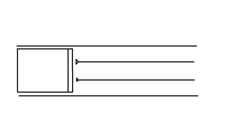

colty-bear
Posts: 250
well when i hit it, it made the end of the pipe flat
like so
also the rubber is very tough i took a big sample and tried stabbing it a few times, like i said very tough outer rubber
