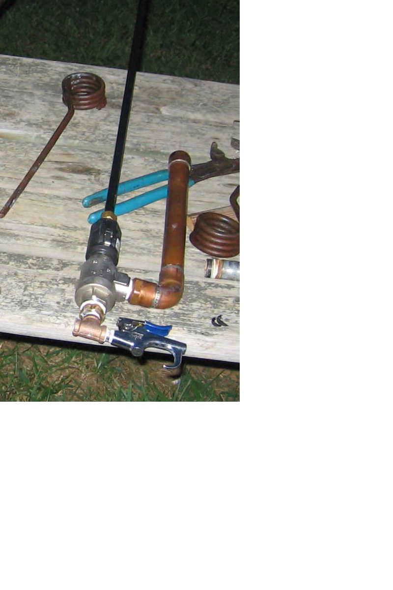

I forgot to add the pic of the gun... so here it is(shown with the .40" barrel), the filler is a paintball qd w/check screwed into the empty(in the picture) part of the T...
filling takes about 2 seconds, filling from a 50lb co2 tank(non diptube valved)...
