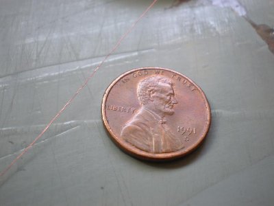

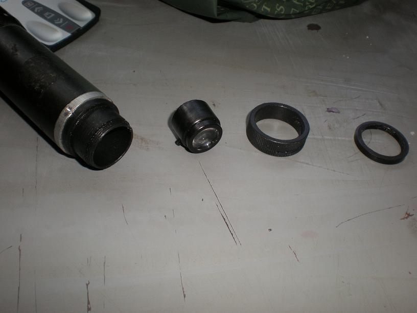

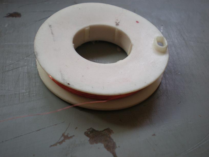

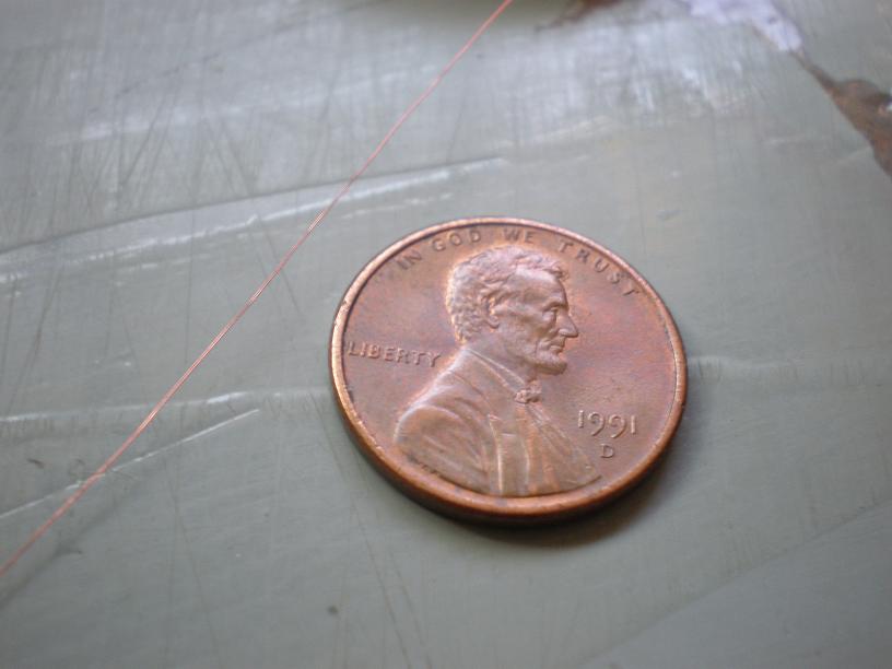

I figured this out after I took apart a cheap scope I had to try and straighten one of the cross hairs, I realized it was just thin copper wire.
This definitely is no where near as good as a real scope but its a pretty fun thing to have and could be made better than some iron sights.

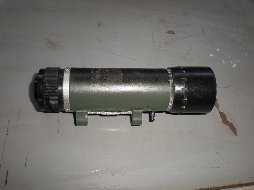

I had one side of an old pair of binoculars, but I assume this process will work with any binoculars you can take apart.
not really sure why but my pictures came out in a strange order, but its pretty straight forward.
Add crosshairs to binoculars

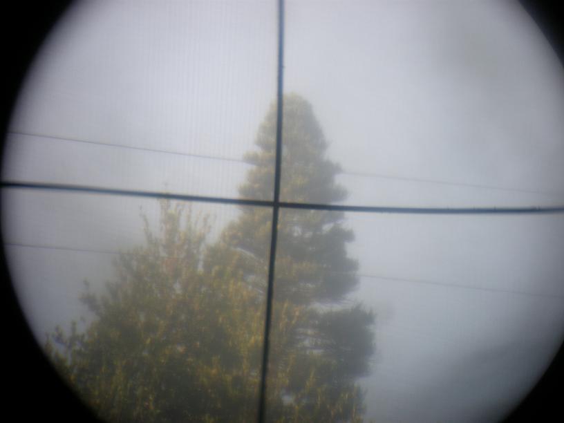

- Now put everything back together, the binocular should now have dark, in focus cross hairs. (probably should have wrapped it a little tighter to get straighter lines)
- now with crosshairs.jpg (38.24 KiB) Viewed 13084 times

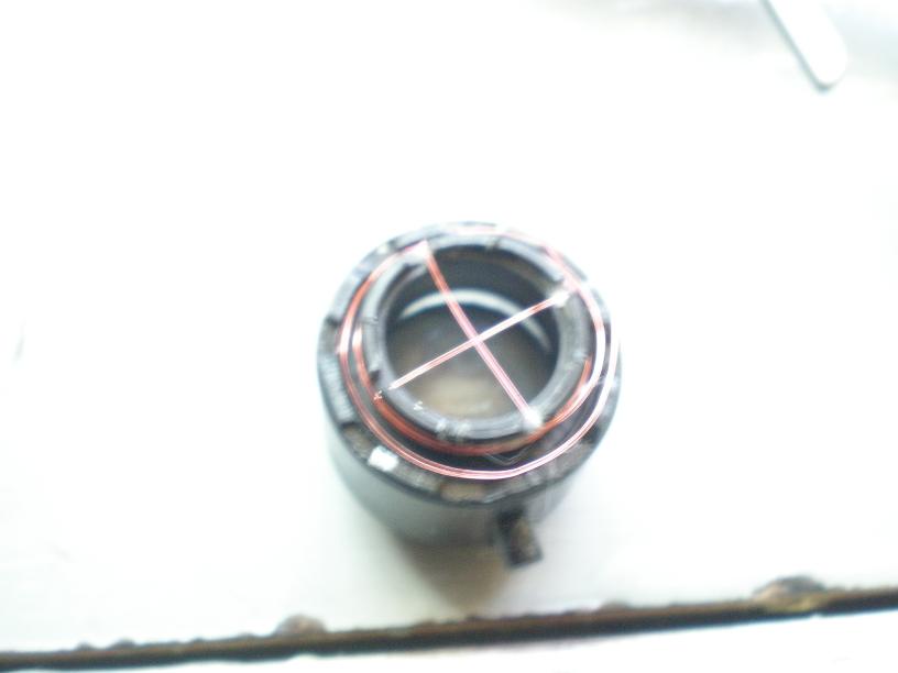

- The plastic piece holding my lens already had 4 grooves in it, I just crossed the wire and wrapped it around the outside to hold it in place, glue might be necessary to secure the wire.
- wrapped lense.jpg (35.38 KiB) Viewed 13084 times

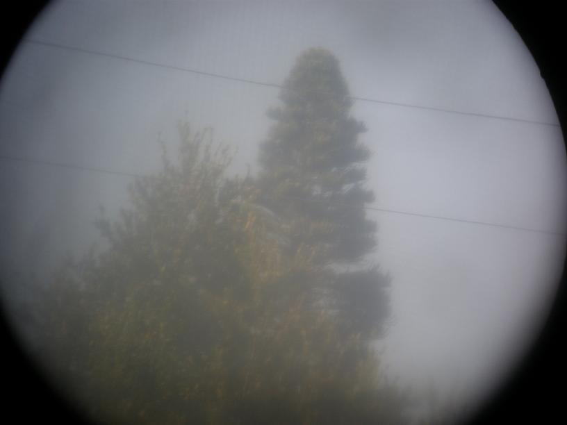

- before any modification
- before crosshairs.jpg (31.9 KiB) Viewed 13084 times
