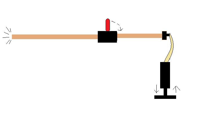

i mean a pump with a cable on it, or a bike pump.
doesnt matter, here is a good example:
(Here is quick pic i've made)
i dont know it's working but if it's working then i dont know how to build the valve on it,
geardog32
Posts: 173
Joined: Mon Jun 22, 2009 9:20 pm
do you know how to solder? if not i would recommend building it out of pvc. the most basic you can get would be a ball valve. just get like a 10 foot section of pressure rated pvc, a ball valve and cap to match, and a schrader valve and gauge if your pump doesnt have one. then cut the ten foot section in half put the ball valve in between. then thread the schrader and gauge into the end cap and glue it all together. and you will need some pvc primer and glue. thats as simple as i can think of.

ok thanks but i really need one from metal, and no i cant solder.
but is there no other way without solder to make one with a valve for a bike pump?
Look at my post above, you probly missed it. You can thread all your parts together.

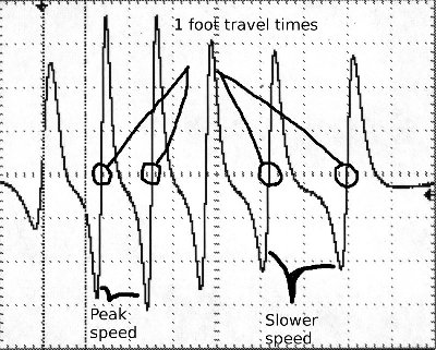

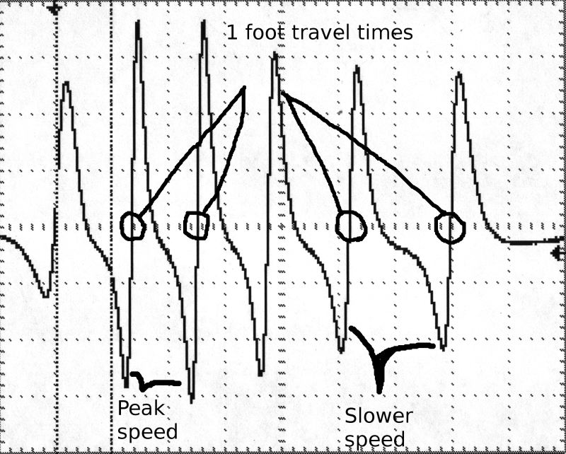

I have test data on a in barrel launch where at low pressure, a 1:1 volume ratio is a poor choice because the projectile slows down prior to leaving the barrel.
Below is a chart with a low pressure launch. The blips are located for every foot of travel in the barrel. Peak velocity is achieved at about 3 feet and then drops off for the remainder of the distance in the barrel.
I like a 2:1 ratio myself, thats your chamber should have 2 X the volume as your barrel.
Funny, If I have to hand pump it, I like it the other way around. It's less work and not much drop in performance at higher pressure. :D With the small compressor I use, the large tank cannon is about 10 minutes between shots at 60 PSI. With the little cannon, it's 80 PSI shots as fast as I can reload. For raw power, it is true the large chamber does perform better.
Projectile is slowing in the barrel at low pressure.
