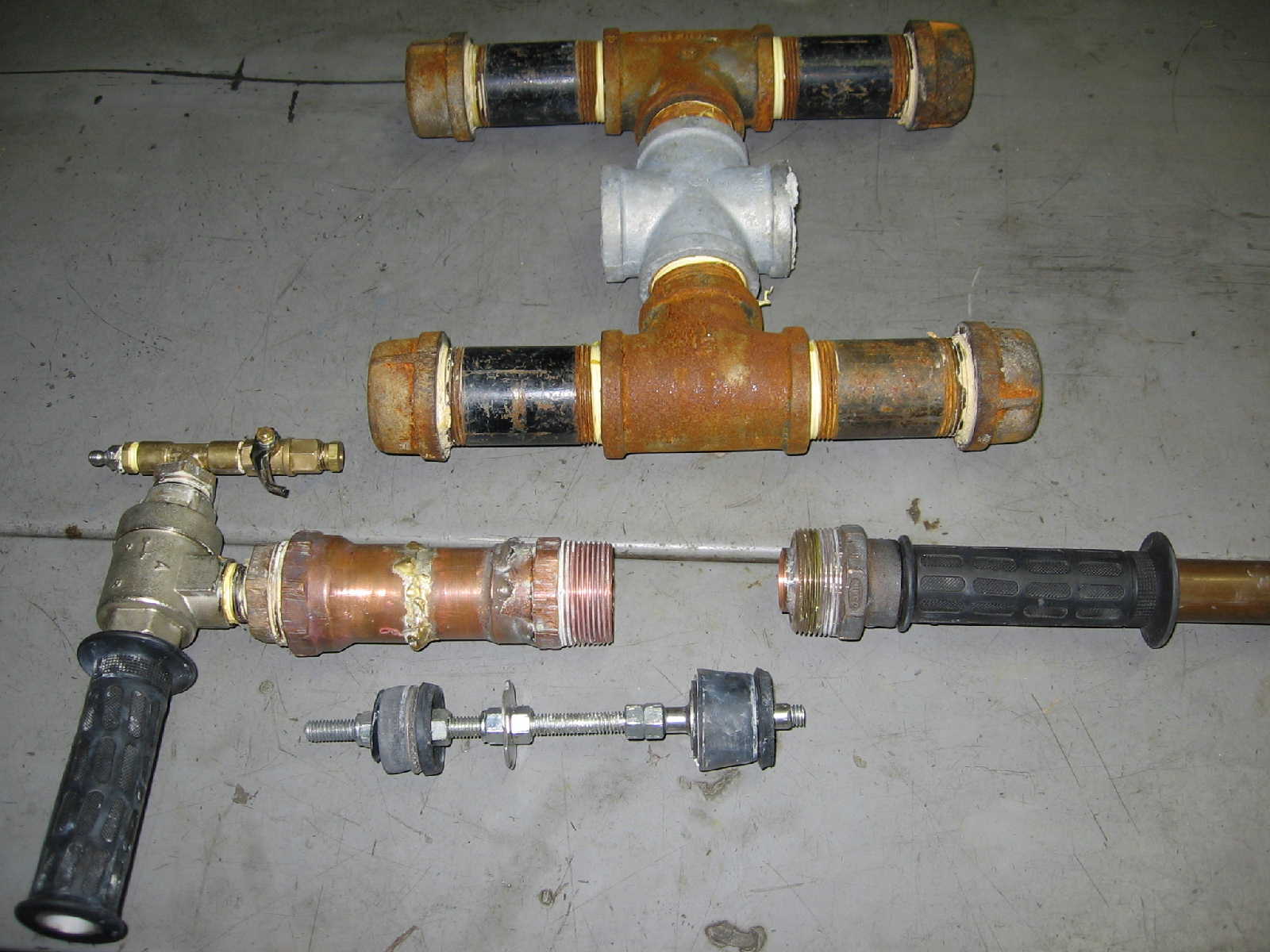

A cup piston is quite easy to make actually....
I use a .25" thick rubber disc that I've punched used a piece of the pipe that it's going to fit into, It's sandwiched between a washer just small enough to fit in the pipe and another that is between 50%-75% of the pipe diameter...
When you tighten down the washers the rubber disc will squish out and forward towards the small washer side...the diameter you will find will now be slightly larger than the pipe i.d., but that's ok, that's what you're looking for.... now it will take a little effort to get it into the pipe and you'll want to lube it as well with silicone or lithium grease...
once it's in the pipe it will allow filling from the pilot side but will not allow air to escape from the chamber to the pilot when fired.. It basically acts as a check valve.... Mine handles unregged co2, I've actually capped the barrel port of the cross and "pulled the trigger" and it held 100% of the chamber pressure...
look at the left end of the decimater piston and you will see what I'm talking about(the larger rubber bit is actually one of the bumpstops that is stuck on the rearmost nut...)

Thanks for a very good solution.jeepkahn wrote:A cup piston is quite easy to make actually....
BTW How do you locate the center of the rubber to drill for the bolt?
(eyeball or what?)

I usually eyeball it... the bolt hole is 1/2 of whatever the bolt size is so that it helps to seal against leaks around the shaft...boyntonstu wrote:Thanks for a very good solution.
(eyeball or what?)
