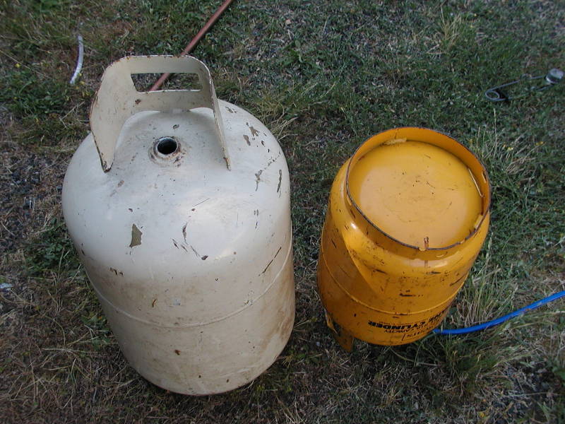

Use old propane tanks. The 11 Lb ones are about 2.5 gallon, right in the size you requested. The 20 Lb tanks are about 5 gallon. The bummer is they are only fitted with a 3/4 pipe thread.
The old style tanks are often tossed and can be had for FREE. The cost of a new valve and recertification is about $50. I was going to have the small tank below fitted with the new valve. They wanted $30 to replace the valve and $20 to certify it. A new tank certification is good for 12 years from date of manufacture. An old tank certification is only good for 5 years.

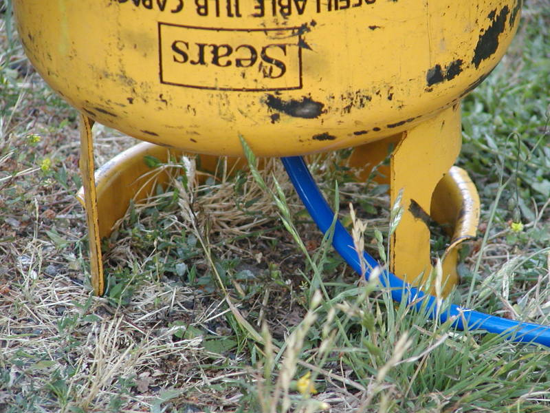

These tanks are the start of my next two launchers. 3 inch and 4 inch.
The large tank is either a 7 or 10 gallon. I'm not sure which. I'll check it later.
EDIT Update. I checked the volume of the large tank. It has a WC (Water Capacity) of 66 Lbs of water which is 7.9 Gallons. At 231 cubic inches per gallon, that would be about 1825 cubic inches. Nice size tank for the 4 inch.

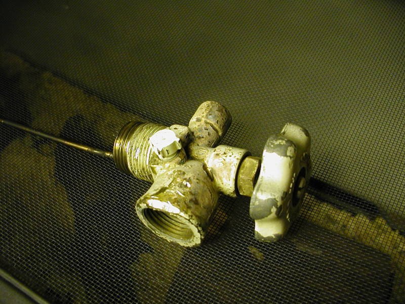

They are very tight. A padded chain vise if you have one and a long 1-1/8th open end wrench is preferred. Don't use an adjustable. It will break.boyntonstu wrote:I once tried to remove the valve from a propane tank and I couldn't do it.
Hints?
The joint compound sets up. For a stuck valve, I heat the valve until it just discolors to soften the sealant. The joint compund tends to set up with age. Then I can get them out. I had to heat the valve on the small yellow tank to get it out. With the plugs removed and guts taken out, I got a little extra flame as the propane expanded from heating.
Do not do this with a tank that has had the valve left open. Air in the tank may leave an explosive mixture.
I used a nail bar in one of the handle slots and against the valve shank to hold the tank while turning the valve with the wrench. An yes, they are VERY TIGHT.

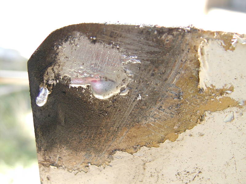

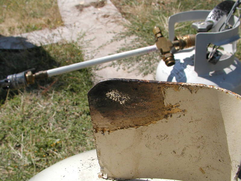

I had to know, so I had to test. Will plumbing solder adhere to steel? To test I picked a spot on the handle and burnt off the paint and gently scraped it with a stick. Let's see if flux will clean it. It didn't work very well, but some solder stuck, so it looks promising.auxiliary wrote:I meant plumbing solder when I said "regular old solder". I looked around my garage and found some silver bearing solder and tried soldering two short segments of steel pipe together by their sides so there was little surface area. I managed to get the solder to flow and when it cooled, I tried to wrench it apart with my hands (didn't work) and then took a hammer to it. With a couple firm taps it broke. If silver bearing solder has this kind of strength with such little surface area, I thing it could be used for securing a steel pipe inside a propane tank (with beveled edges of course).
I used a file as I didn't have sandpaper handy and did a quick job of removing the years of crud. Fluxed it and tried again.. Much better. It should work well with plumbing lead free solder and flux or silver bearing solder. Clean is required.

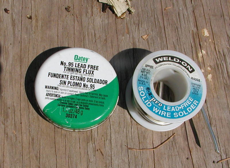

I also took a picture of the flux and solder used for this test and one of the old valves. I bent the outlet reefing on it before it came loose.

I just looked up the MSDS on the lead free solder. By weight it is >90% Tin, <5% copper, <2% silver, and < 2% Antimony.spudtyrrant wrote:i hate lead/tin i would get some tin/antimony if i tried anything
