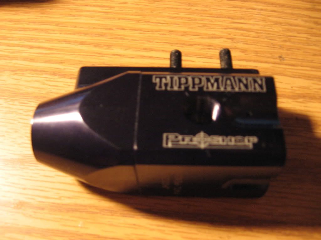

The reg I have picture screws directly into the tank (without the pre reg) form what I've heard.
But nevermind, believe it or not I think I found something lying around.
I think thats what you call an ASA? Does anybody know anything about it? Will it work with HPA and then what else do I need to regulate down to 70 psi.
Edit found link:
http://www.airsoftpost.com/genuine-tipp ... 25706.html
So what else do I need.

yes that is an ASA or air source adapter. the way this would work on a paintball gun normally is a tank like the one you linked earlier would screw into the ASA then you would run a hose from this to a regulator which is normally the front grip on the paintball gun. one way you could do it is take a tank like the one you linked then with macro line from the ASA go to something like this http://www.actionvillage.com/031-138-0028 and then screw this http://www.actionvillage.com/036-187-0001 onto the regulator and then go to your spud gun. it would be pretty sloppy but it would work.

Well multiple questions now
Couldn't I just ignore the second regulator since stability doesn't matter too much? This hypothetically reduces it down to between 0-800 psi and then I could just run it to a hose -> my cannon?

oh, i didnt even see that it was a reg too sorry i thought it was just an ASA yes you could just go from that to your cannon since stability isnt important.

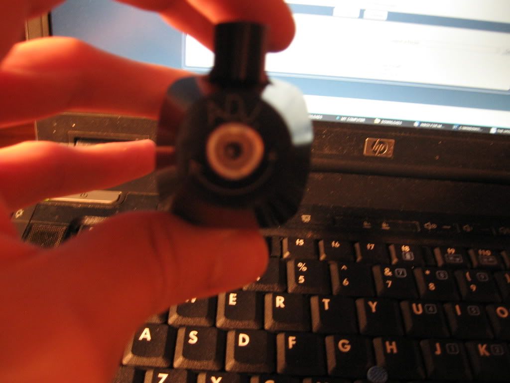

So it'll work with HPA?

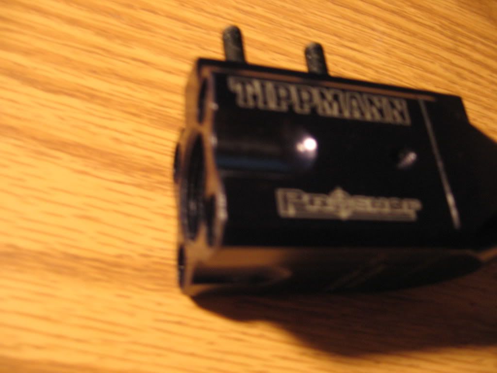

Andddd there are two holes on the side for this. I assume the smaller hole is the regulated output? What type of connector do I need there (like threading etc.)
Edit: Pic from other side
Sorry for blurriness.
And turning it clockwise should increase pressure I assume.

Another double post again, I'm just trying to get this right before I have to pull PVC shrapnel out of my arm.
Is the bigger hole for a gauge?
