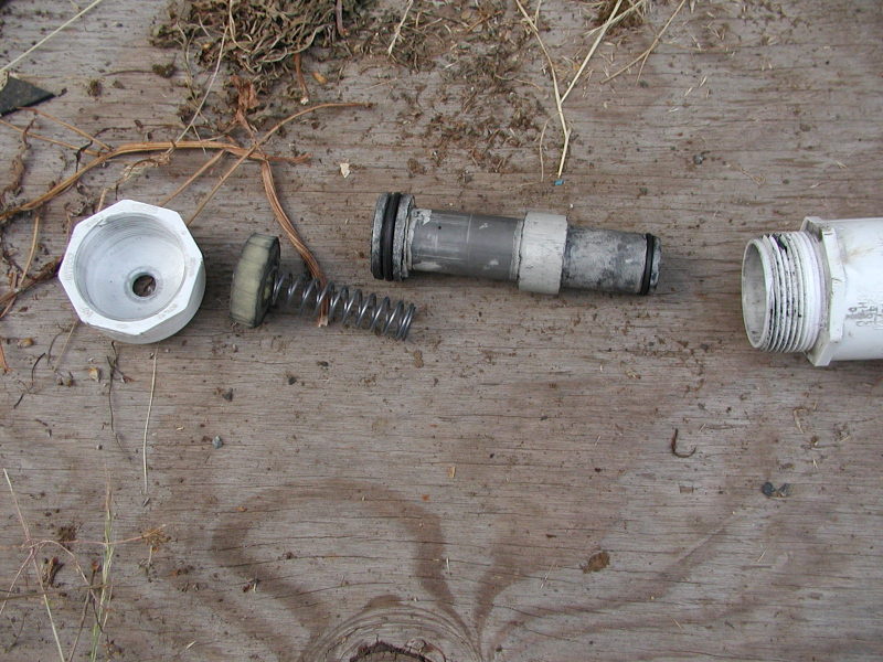

I am searching for a lubricant to be used in lubing an aluminum hybrid piston with a viton o-ring. Many lubricants I found will not erode the o-ring and have high temp ratings, but I wonder if they will combust upon firing the cannon. I think this may be a rare topic for a specific lubricant use. Correct me if i'm wrong. I also have some PTFE o-rings that are indestructible, but they are harder and cause more friction on the piston due to the tighter grip. I'd rather stick to the Viton since it is softer and lets the piston glide easier. I looked at liquid wrench just for fun and it looks like it might work despite being very common. Another option I thought might work is one of the dry film lubricants.
