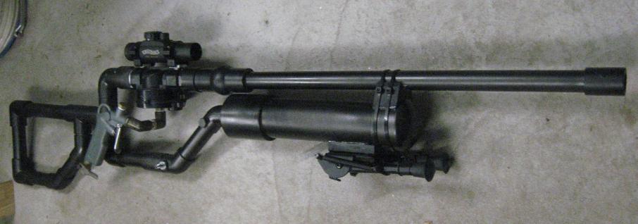

This cannon has been posted on here before (I'm talking almost over 2 years ago) but it was very basic and since then it has had rebuilds, paintjobs, accessorys and lots of little adjustments.
Specs:
Type: Pneumatic
Ammo: 16mm Marbles
Pressure: 80-140psi
Configuration: Under-over
Valve: 3/4" Modified Sprinkler
Trigger: Blowgun + Safety Valve
Red+Green Dot Sight
Adjustable Bi-pod
Sling (not seen in photo's)
Gun Metal Paintjob
3/4" Stock
Ball valve breech load
16mm Copper barrel cased in 3/4" PVC
Enough talk heres the pics:

Nice, bit big on the chamber volume for my likes but very well refined :)
Is the bipod an actual Harris or a cheapo imitation?
Scottaiii
Posts: 10
Joined: Mon Aug 03, 2009 4:34 am
Cheapo imitation unfortunatly, but it does the job :lol:
I can't really think of much else to do with it, laser pointer maybe, and flashlight. Just to spice it up.
Scottaiii wrote:Cheapo imitation unfortunatly, but it does the job :lol:
Fortunately you mean, you don't want a bipod that costs more than your launcher :)
Integrally suppressed barrel of course ;)
I would not bet on that ;) It Cost me over $150AUD to build + more for mess-ups and just trying things out.
Well yes that would not be such a bad idea, I've built an attachable silencer before, but internal would be nice. But how much power will i really loose if i was to do that, say 16mm barrel, cased in 1inch silencer?
Thanks.
- Scott.
If you port say the last 3 inches of the barrel you shouldn't really notice a decrease in power without a chronograph.
Scottaiii
Posts: 10
Oh alright then, well i might make the silencer from the end of the chamber to the en of the barrell. Ill have to work on it. Thanks.

My only suggestion, all Pneumatic PVC guns NEED pressure gauge. for safety. I've show my cannon a few times just to have 10-15 psi of "left over" pressure.... stick a new piece of ammo in.... and accidentally fire...
So, over all Great looking gun. You juts need a gauge!

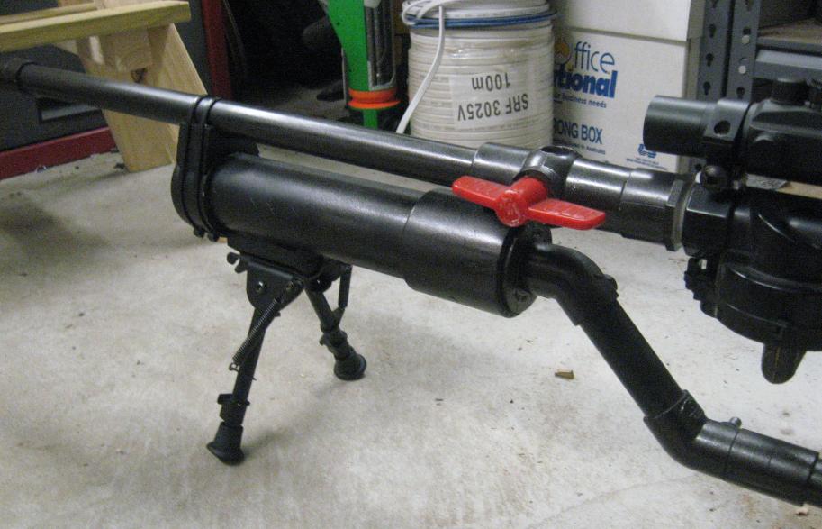

covey12
Posts: 260
im guessing the ballvalve is a saftey?
“The object of war is not to die for your country but to make the other bastard die for his.”
jmadden91
Posts: 246
Joined: Thu May 07, 2009 6:03 pm
Location: Queensland, Australia
No its a loading mechanism. He states in his post that it has a safety, so im assuming it doubles as both.
