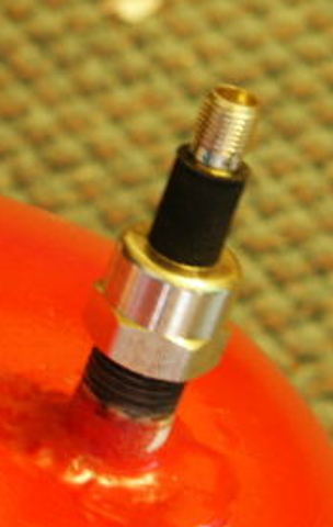

Sweat (solder) with 95/5 Tin/Antimony and flux, or epoxy such as JB weld.

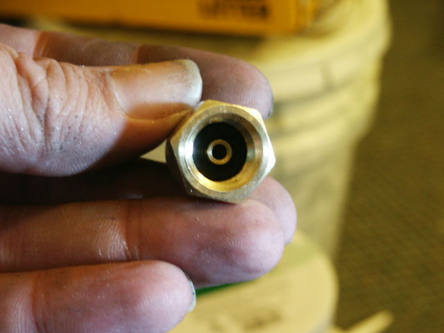

The rubber can be turned down a little in a drillpress and installed into a pipe cap. The rubber would then form a gasket as it screws down onto a pipe nipple.
Example photo attached.
Fill valve installed
Fill valve installedwiki.JPG (22.28 KiB) Viewed 3464 times
Bottom view showing the rubber seal.
