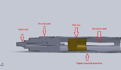

Well here's a picture!
Also, I am building a 300 bar HPA conversion for a chinese CO2 Airgun, yes.
I will get a .223 barrel for it, I expect something above 90 footpounds from that.
Well the drawing so far, allmost done,<br />Only need to draw the srping guide and it's finished.

@ necrosis, how is the valve mounted on the qb, and do you have any links to hpa mods that haven't become bombs?
Any data on the material used to make the pressure tube? Or are you planning to not pressurize the tube?
Thanks.

The valve will be fitted to the pressure tube with a threaded connection, the holes in the "action" Are there to mount the whole thing to the frame.
The pressure tube will be made out of 30x3mm precision hydraulics pipe.
