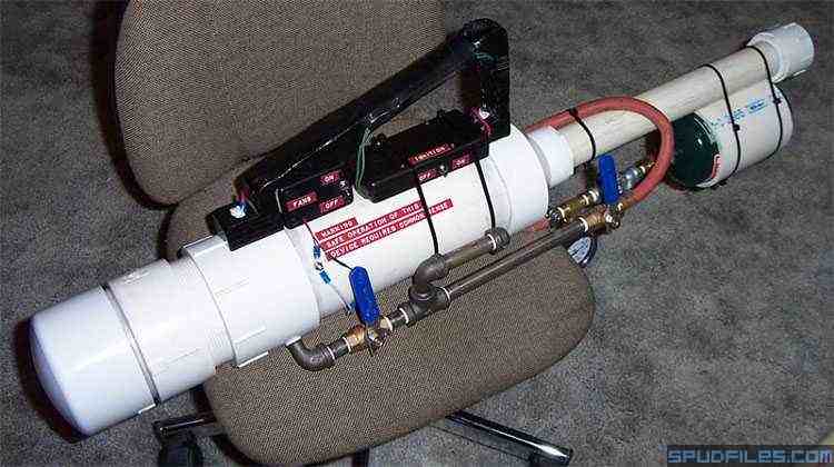

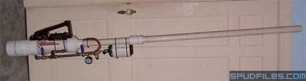

This is my newest gun. It's pretty much finished, but I'm still tweaking it. This is what I would call an advanced combustion gun.
It features: Breech loading. No more ramrods. Onboard propane injection. Fueling is fast, clean, and easy. 65,000 volt stun gun ignition. Super reliable. Two small centrifugal fans for fuel mixing and chamber exhausting.
Barrel screws off for more compact storage.
This thing is almost entirely self-contained. The only things needed to operate it that are not already attached are common sense and ammunition.
<img src="http://www.spudfiles.com/official_pics/ ... _23_03.jpg">
<img src="http://www.spudfiles.com/official_pics/CSVR-4.jpg">
Here you can see some details and read my labels. It's hard to see, but the trigger is a black momentary rocker switch on the handle. This was the original trigger switch in the stun gun.

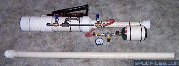

Here it is with the barrel attached.

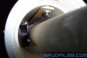

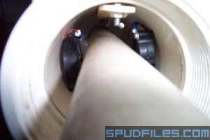

And here are two blurry pictures of the inside of the chamber. The two black things on either side of the barrel are the fans, and the thing at the top of the chamber is a spark strip that produces four sparks from the ignition. The strip itself was cut from thin 8" PVC pipe, and the electrodes are short pieces of fence wire.
