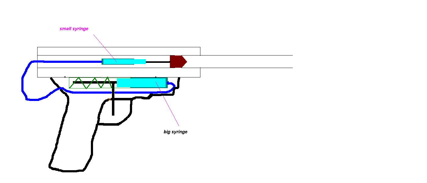

ohh here is a simple way to open the QDV via hydraulic system (aka JSR syringe fetish syndrome) :wink: sorry for crappy quality but I don't have much time ATM
