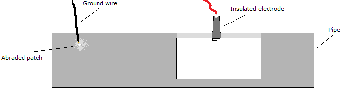

You can use one wire that is insulated as the "hot" wire, and then use the chamber walls as the "ground".
I.E. - one wire is well insulated from the chamber walls (via rubber coating, epoxy, etc.... or you can use a spark plug), and the other wire is simply soldered to a spot on the metal chamber. The spark will jump from the hot wire to the chamber wall, or in the case of a spark plug, the electrode to core.
Craptastic drawing.
Craptastic drawing.
