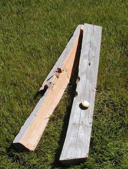

There is a big issue with the design depending on the volume of air that can get through the hose into the barrel. There is a limit to how much air will go through a hose. This limit limits your flow in the barrel.
As mentioned above a piston valve will make a lot of difference, but only when a local pressure storage container is located at the valve.
With a piston valve and a chamber you can expect this type of performance at lower pressure.
