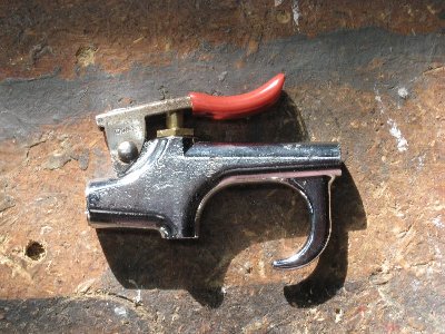

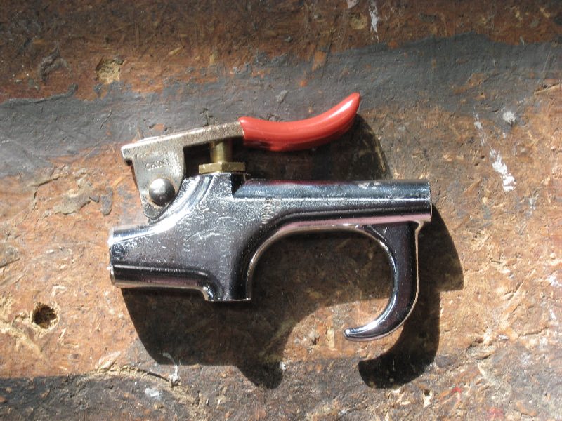

This is the blowgun that I am modding.

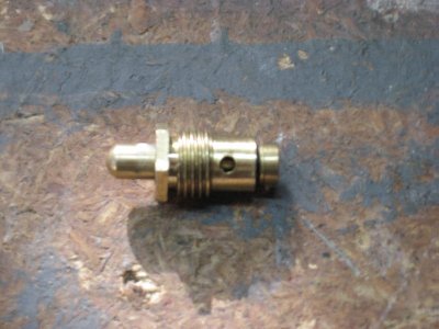

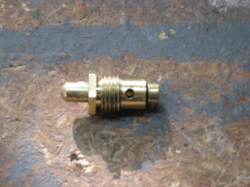

Valve from blowgun before modification

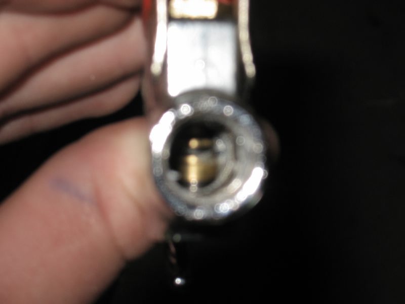

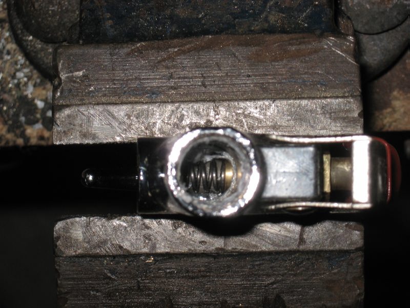

This is the 1/4" side of the blowgun, which is connected to the chamber and holds the pressure. Originally the hole at the very bottom of this is only a few mm in diameter, use a drill bit to increase the size of this hole and allow for more flow to the valve

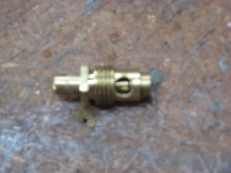

New, bigger hole drilled into the valve inside the blowgun. I used a 5.5mm drill bit. Make sure to remove the 'push button' part first and to clean the hole afterwards.

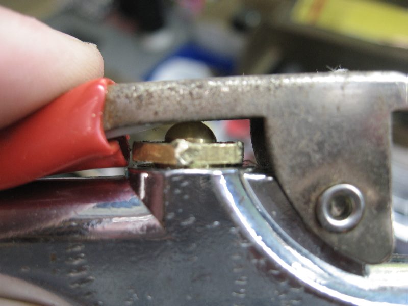

Piece of plastic I found in the garage. Anything hard, that wont compress, will do. This plastic is about 3mm thick

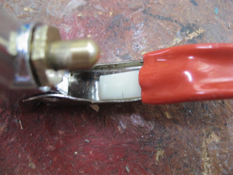

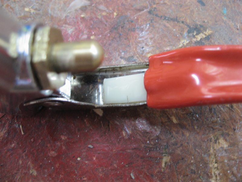

Piece of plastic glued under the handle to further depress the push button and allow for more flow
With the bigger hole drilled through the 'chamber port' of the blowgun and the plastic added under the handle, the valve opens with more flow
