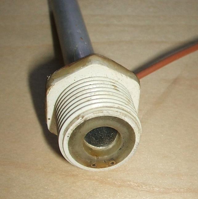

I had made a nichrome fired burst disk a while ago, it always fired instantaneously. You need a heat sensitive material like mylar to ensure reliable function.Lentamentalisk wrote:I have found several designs in the past that use a hot nichrome wire to heat a plastic burst disk to cause it to fail, but those take time to warm up, and don't always do so at exactly the same rate.
Another idea could be to have some sort of spring loaded valve that is held shut by some chord than can be cut by a hot wire. (edit: but it seems you already thought of this, hadn't read your above post properly

@JSR: Question about your nichrome wire burst disk. How did you ensure the wire was touching the burst disk? Did you attach it with a bulge, so that it pressed up against it? That is definitely worth considering, especially if we set it up to dump a capacitor through the nichrome wire, or something like that, to ensure it gets hot fast.
