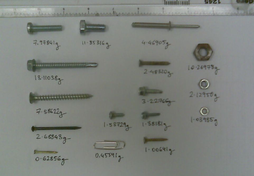

I have a balance accurate to 0.00001 grams at work if anyone needs anything specific (that I also have in my possesion) weighed ;)

ball bearings
0.26808211082 oz.
