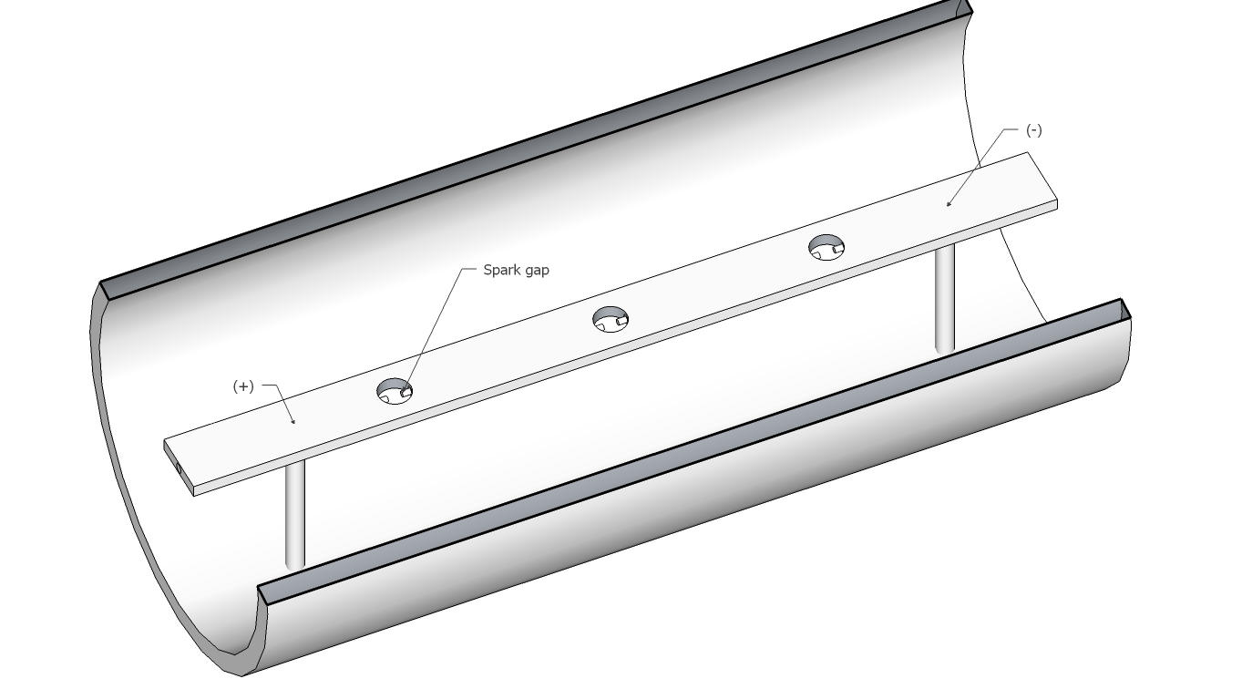

What about a design where the spark strip is simply supported in the center of the chamber? You could just put holes in the strip and place the electrodes in the center of the holes. I wouldn't think the thin profile of the strip would interfere too much with the flame expansion (but I'm just assuming that).
That's the technique starman uses in Triple Thunder. Seems to work.

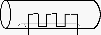

Didn't someone make a strip similar to Latke's except there were heavy wire (like coat hanger) electrodes up to the chamber's center line? There was very little added surface area near the chambers center, just the heavy pieces of wire that looked like a square wave with breaks in the tops.
Yes, except he used like 1/4" thick copper. Then there's starman's spark strip, which is more suited to my taste.

jimmy101
Posts: 3211
Location: Greenwood, Indiana
Has thanked: 7 times
Been thanked: 18 times
This is what I was thinking of.

Jimmy I like your design but the only problem I see is that it would be hard to service the sparkstrip if your using a small diameter chamber....

theBOOM wrote:Jimmy I like your design but the only problem I see is that it would be hard to service the sparkstrip if your using a small diameter chamber....
Actually, I figured it would be done the way Latke did his. There's a screw at each end of the strip the goes through the chamber wall. The screws also supply the electrical path.
If you remove the 2 screws the whole thing will fall out'a the breech.
The strip probably needs to have either threads, or nuts permanently mounted to it, since it'll be nearly impossible to get into the chamber far enough to hold nuts while the screws are installed.
Hubb
Posts: 2390
Location: South Georgia
jimmy, that was the exact way I built the spark strip that went into the combustion I linked to above. Works great, easy to use, and all that good stuff. Like I also mentioned, I have since redone this particular spark strip to make it even better, but that's for a later topic.
