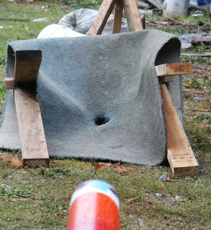

this is the golf ball cannon that MrCrowley shows you how to build in this instructiable http://www.instructables.com/id/Golfbal ... That-Shoo/ i built it pretty close to the way he shows in his TUT with a few mods, i beleive i have a longer chamber and barrel, i can get it to shoot through 4 layers of carpet and 1" plywood, ill up more pictures and damage pictures in a little bit

Carpet is relatively wimpy. I was able to shoot a t shirt through 2 layers of carpet. The 1 inch plywood is impressive. Good job.Northir wrote: i can get it to shoot through 4 layers of carpet and 1" plywood,

Done and done
also more damage!
thats 3/4 form board with a piece of 18 gauge aluminum ducting screwed to it
