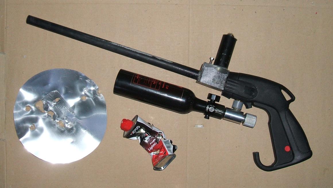

Lighter fuel can with 0.5mm aluminium backplate, it kept being blown over by the blast because I was too close.
Ancient Amiga mouse with 0.5mm aluminium backplate
Computer power supply, no penetration yet but its time will come when I up the pressure :twisted: note how it didn't jam in this one, I think I had turned up the flow from the tank fully
This was the basic idea, pressure washer handle + 3000 psi 13 inch<sup>3</sup>paintball tank:
+ 3/8" ball bearings :twisted: the brass tube in the picture is 3/8" external diameter and was used as a mandrel for the cast epoxy barrel

The pressure washer valve wasn't leaking, that's rated at 2200 psi.
POLAND_SPUD wrote:I don't get it... they are standard fittings, right ??
The pressure washer fitting is 3/8", but the valve I have on the paintball tank is 1/8", so I epoxied a 1/8" nipple (the bit you can see here covered with a grey pipe) in place but didn't support it enough so it sprung a small leak. All repaired now, as I should have done it in the first place, to be re-tested when I'm confident it's fully cured :)
what's the barrel length?
14.5 inches

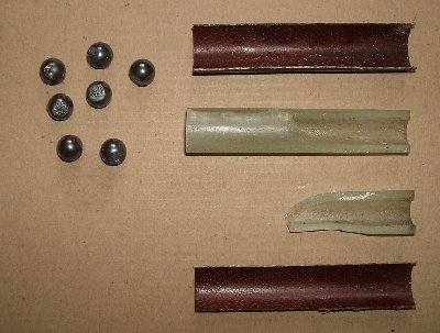

Well, did some testing at 850 psi. Reliability is still an issue, but bloody hell, the power! And the NOISE! My ears are still ringing :)
Here's some single shots, straight through steel case of the PSU :D
Unfortunately, the muzzle end of the barrel objected at some point and shattered, so I was forced to do a BtB and hack off a couple of inches :) also, check out the (macro :D) view of the 3/8" bearings damaged by impact.
