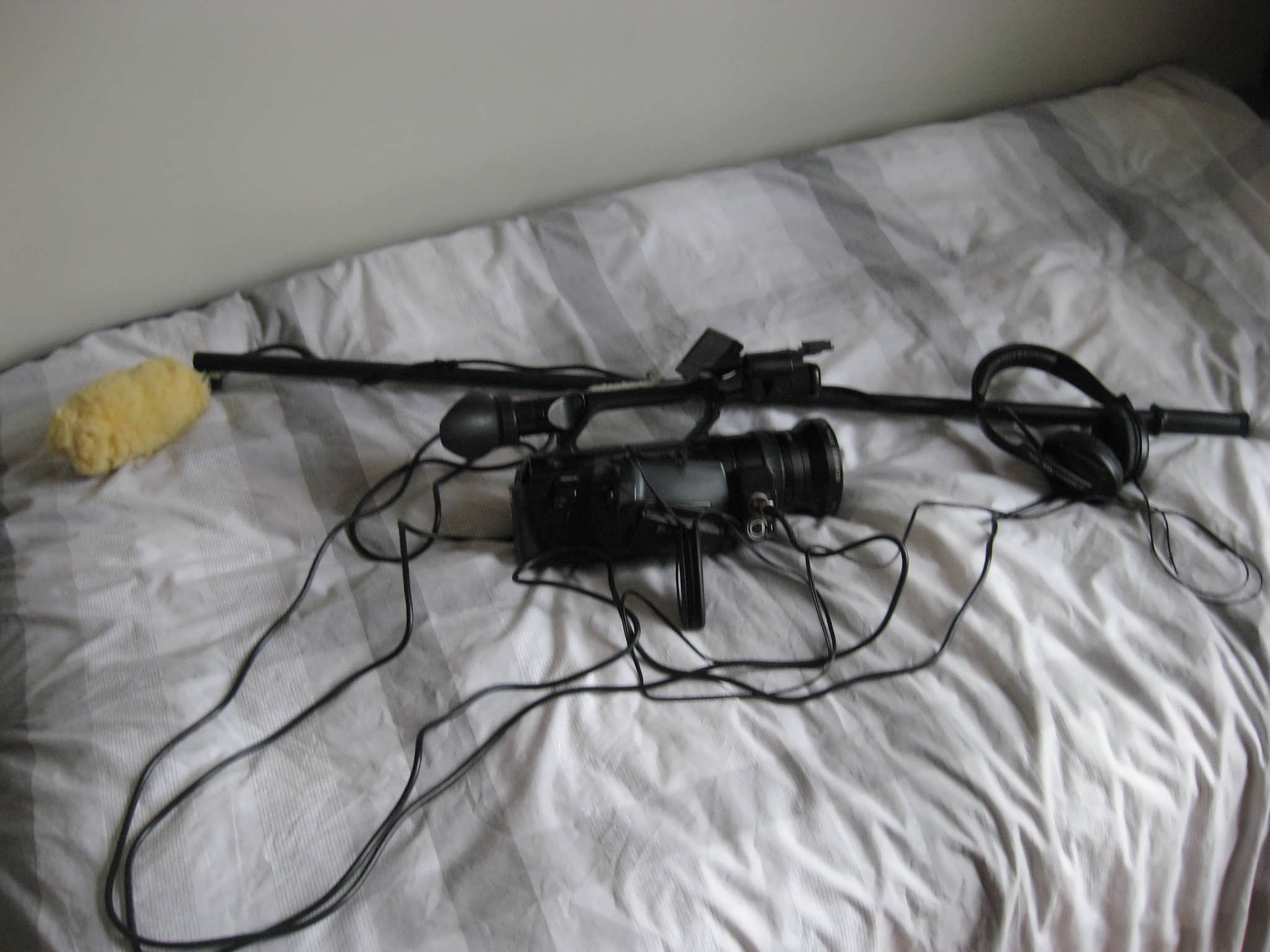

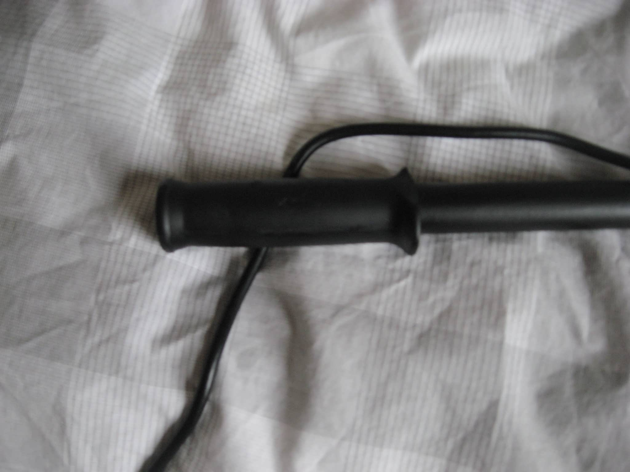

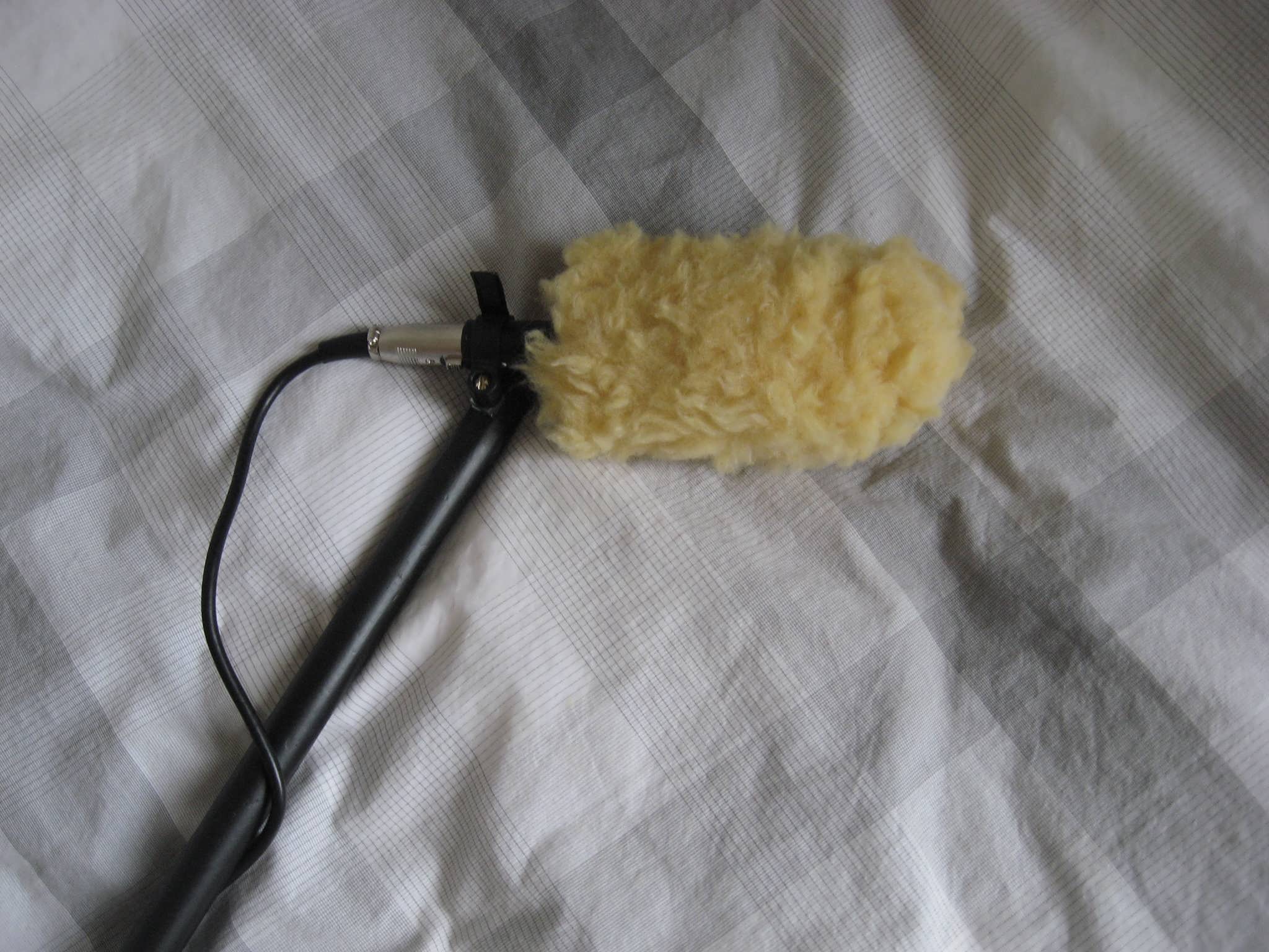

Made this today because sound quality can really ruin anything you film. It seems to work pretty well so far. We can hold it out the window of the car driving at about 50mk/h and you can only hear the car and outside noises, no muffling at all. Before, that would be all you heard.

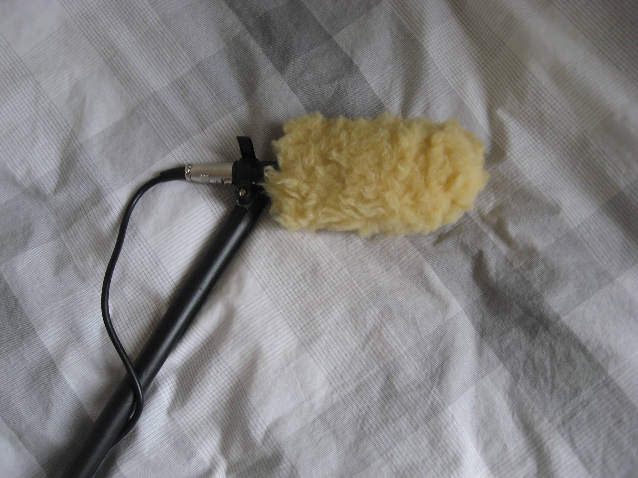

The mic windscreen is made from a 4" thick piece of foam cut in to a 8cmx8xcmx10cm block which I shaped to what resembles a semi-Prolate spheroid (egg/rugby ball shape), hollowed out the inside and slipped the microphone inside then used a rubber band to make sure it stays on.
Then I got some fur fabric from a car polishing mit which I cut up and sewed to fit over the foam. I need to get a rubber band just to make sure no wind goes inside it from behind where it's open (so it can be removed).

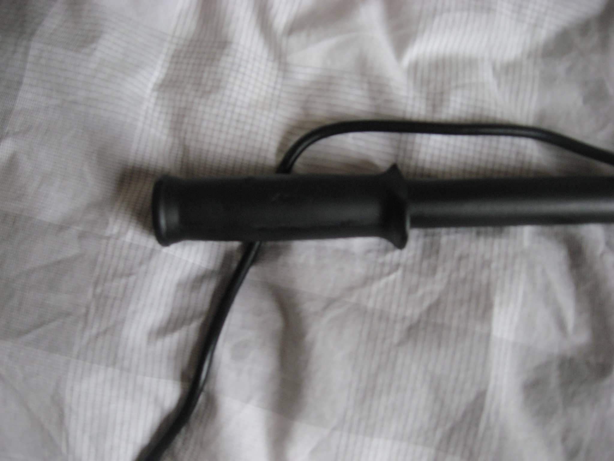

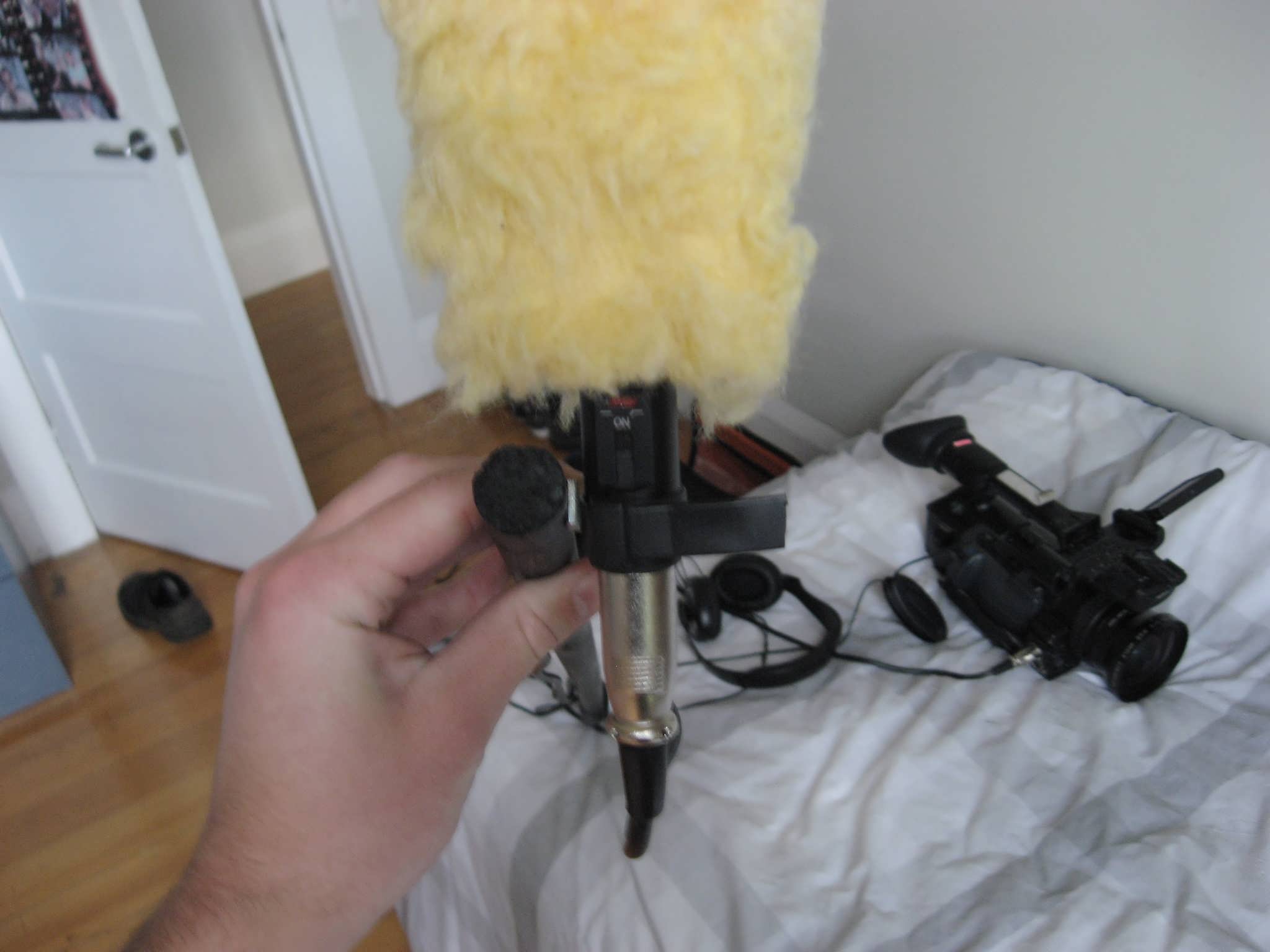

The microphone stand is just a wooden broom stick with a grip I got fron an old drill forced on to the end. The microphone is attached using an adjustable plastic circle thingy which tightens when I pull the strap. Conveniently it has two tabs for a bolt to thread through at the bottom so it can be fastened to something. So I threaded a bolt through this and through the wooden broom stick. This allows me to change the angle of the microphone but it's strong enough to stay in place.
Then I just used two cable hook thingys which you can clip a cable under so it keeps it in place. They also allow me to remove the cable, a big factor of this design was being able to remove and disassemble everything so nothing was permanent.
As usual, I have made a pretty long post to answer any possible questions I can think of, so here are the pictures:

Nice!
The proof is the quiet performance at 50KmH.
I wonder if your mic would be a big improvement for chrono use?
