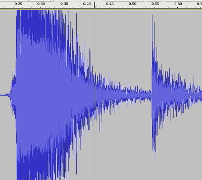

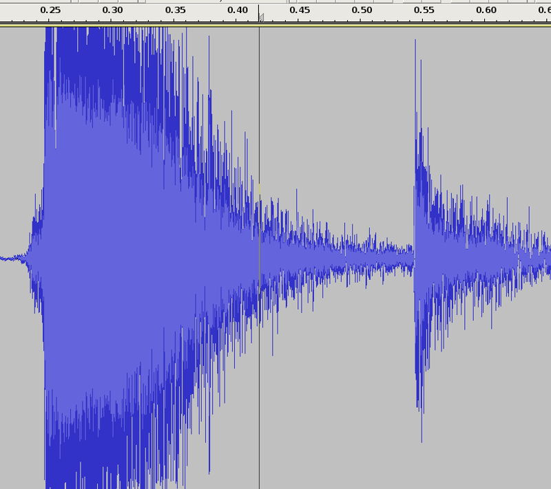

yeh techinician that makes sence. Anyway i recorded it again with Mic centre.
First recording:
Second recording:
First recording:
Second recording:
gunshot4.rar- 40m 140psi mic at target
- (36.89 KiB) Downloaded 441 times
gunshot5.rar- 40m 140 psi mic centre
- (19.54 KiB) Downloaded 477 times

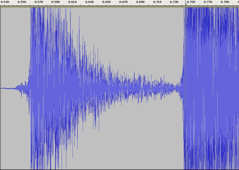

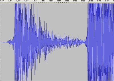

Very nice. I took the liberty of grabbing screen shots of the waveforms with a little zoom in on the area of interest.
Speed of sound is 343 meters per second. If you add the travel time for the sound to arrive from the muzzle to the time audacity gives you and compare results with the second shot, you will see the average flight time of both shots.

In the first example, sound has to travel from the muzzle to the mic. Sound at 343 meter/sec travels 1 meter / 0.002915452 seconds. In 40 meters the sound takes 0.116618 seconds to arrive.
First shot, sounds arrive at 0.561 and 0.742 seconds. The difference in time is 0.181 seconds. Add in the muzzle sound travel time of 0.1166 and you get a travel time of 0.2976 seconds. The muzzle blast happens before you hear it so the sound travel time must be added to the measured travel time.
In the second shot the travel time from the muzzle and the travel time from the target are the same, so we observe both arriving late by the same amount.
The muzzle blast arrives at 0.2464 seconds and the target impact arrives at 0.5440 for a travel time of 0.2976
I am impressed with the repeatability of the shots. Repeatable to 3 significant digits. I'm very impressed. This repeatability is one of the reasons I recommended an air cannon with accurate pressure control for the golfball engineering challenge by the way. Repeatability is very good with the cannon. With other parameters under tight control it could do well at hitting the targets.
Average flight velocity is based by distance divided by time. 40 meters divided by 0.2976 gives an impressive 134.4 meters / second.

For an average speed for 40 meters this is still very impressive. Well done. As stated already, muzzle velocity is higher, much higher. :wav:

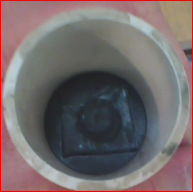

Wow thanks guys, heaps of help.
here's some pictures of ammo and all:
Sorry I don't have any scales so i can't tell you how much it weights.
- Piston in chamber; to show fit
- piston in chamber.JPG (22.19 KiB) Viewed 11450 times
