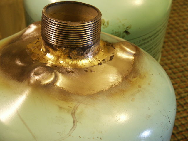

You don't have to weld threaded fittings. Steel is generally stronger than aluminum and can contain more pressure. I myself like aluminum since its lighter and still very strong. It all depends on the cannon. What size cannon are you going to make?
Welding or brazing is an option where screwing it together isn't an option, such as the valve built inside a propane tank.
Valve pipe brazed inside the tank
