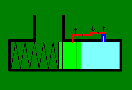

I came up with another idea on how to make an auto pneumatic. When the pop-off valve on the right pops up, it hits a lever which lifts the catch on the piston allowing it to slide forward and work like a normal piston valve. After the air is dumped, the spring pushes it back and the catch grabs it and the air builds up again. The thing I'm worried about most is the strength of the catch, the spring will dampen some of the air's force but not all that much.
Auto Piston.PNG (4.56 KiB) Viewed 4403 times

Your above system, in short, is when the pressure reaches a desired pressure it allows the piston to move. This system uses a spring-loaded pop-off saftey valve, and by adding that mechanism you will proably prevent the pof-off from activating.
To solve your problem you can look at BCPneumatics AutoPneumatic. It uses a pressure switch, and when the pressure reaches a certain pressure it will either open or close the circut. So you could use the same basic design as above and replace the pop-off for the pressure switch, then switch out the "locking" mechanism with a electric soleniod. A problem you might face with this is when the piston opens in closes there is a great possibilty that it will rotate, therefore the alingments of the holes will be off. You could simply cut a groove all the way around the piston to fix this problem.
One question though, do you ever intend on building the designs you post?
I liked the 1st desigh a lot better, i think this one with the out side moveing parts has the possibilty of getting damaged dureing transport/handling/dirt interferance.
