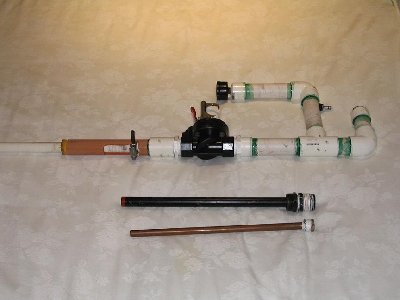

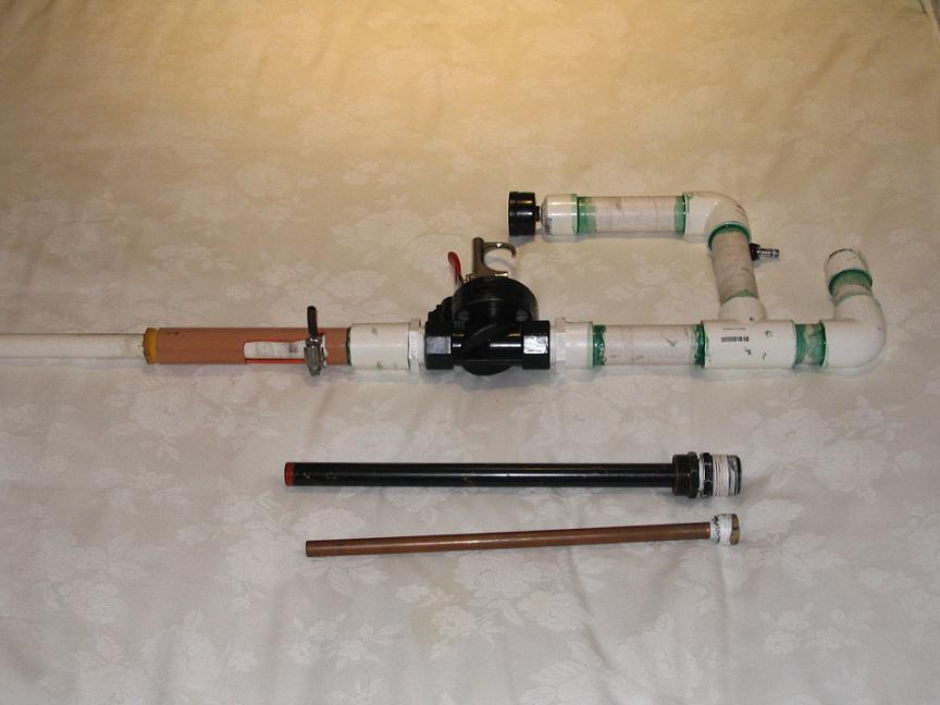

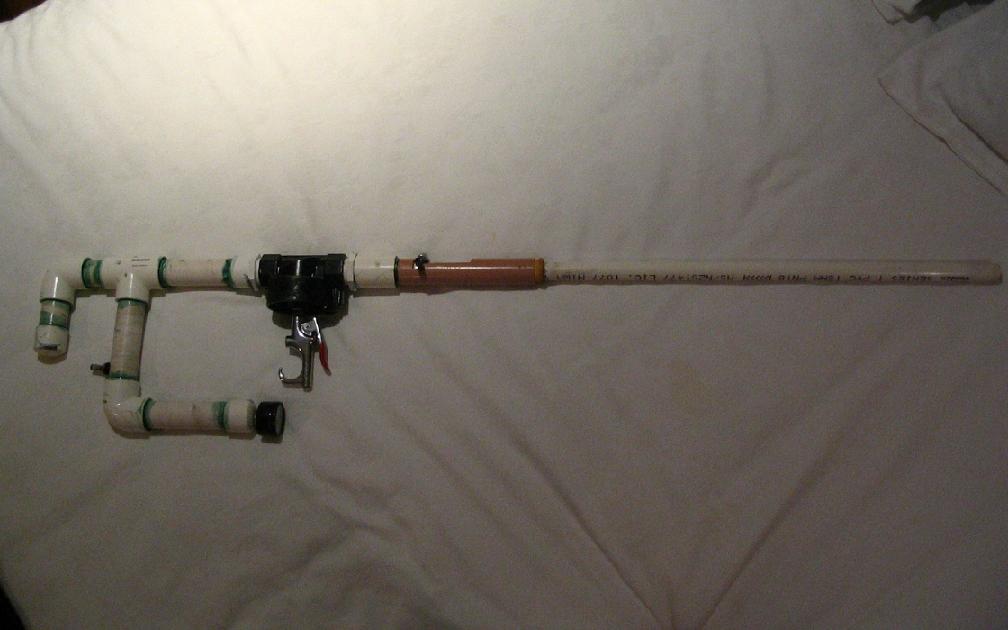

this is my newly created marble gun. it has an airtight breech loader (kinda ghettoish though). i made this one after my last pneumatic exploded, plumming store told me that dwv was pressure rated to 130psi, pfft my ass it was! blew up cutting my ankle pretty good! this time i got class 12 (sch40) and class 18 pipe (sch 80). Very accurate and great fun!
Also i keep hearing of people being able to get more than 1 shot out of one pressurization. how is this possible?

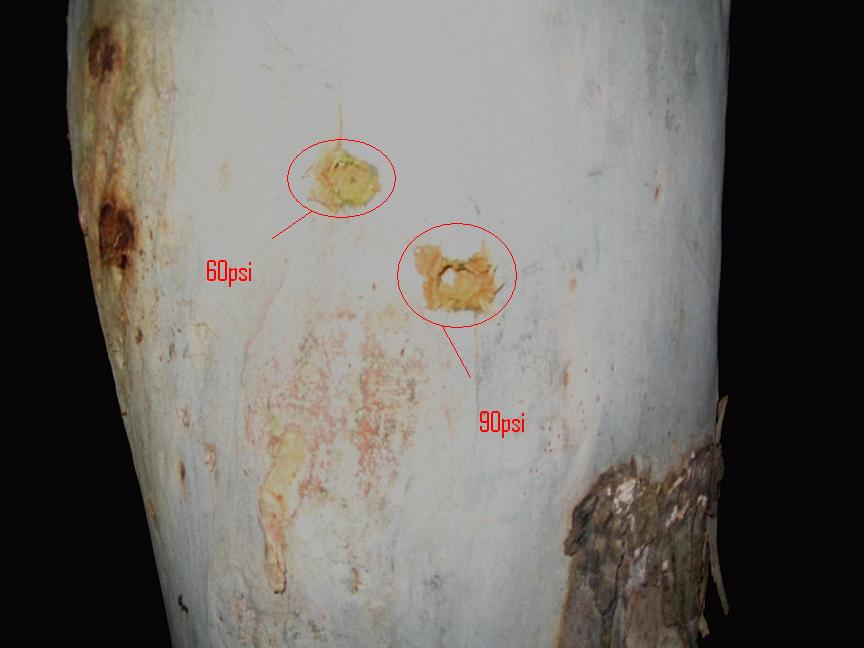

take that tree!
take that tree!
compact copper barrels
Breech loaded 1/2" barrel

Nice,and good damage to the gum tree cuz they are hard!And actualy our class 18 pipe doesnt have a higher pressure rating as sch 80 :x Whats the range on that thing and wouldnt it have been cheaper to buy a section of 50mm calss 12 pipe and fitting to have more chamber space and less bends for more power and also it would be alot cheaper then all those parts..just a sujestion..helpful critasicm(spelling??)Whats your farthest shot?i want 2 compare :P

i chose that type of design primarily caus i wanted it to look cool, have a nifty shoulder rest and a fairly small chamber so i didnt have pump much. since marbles are 13mm and the barrel is 15mm i put a bit of tape round my marble to get a good seal, this then of course makes them very innaccurate and shortens there distance by alot but doubles the power over a short distance. though when i just place the marble with no tape it goes a good 250 metres
