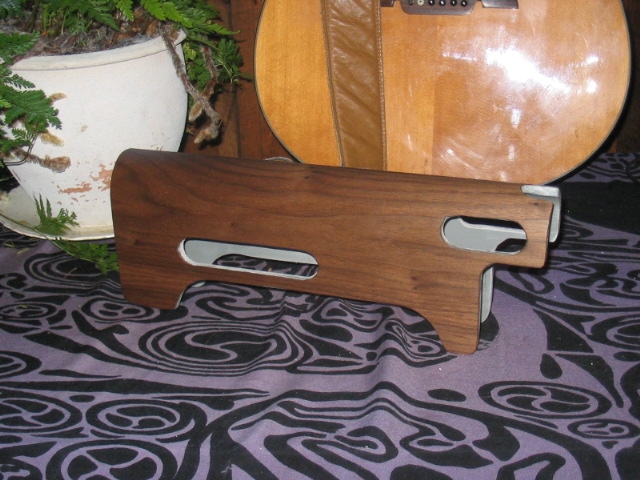

Below is a pic of a walnut veneer with oil finish pvc cannon stock I made yesterday. As fancy as your stock is I don't know if you can get the detail your looking for wit pvc, but the below link is to a supply house that you can buy self adhesive veneer that works very well and is easy to apply.
http://www.rockler.com/product.cfm?page=2213

Thanks mate, I've seen your stock, and though i may or may not have left a comment, i found it VERY well made. thanks for your post.
I am unexperienced with veneer and the simpler the better, your solution looks good, though I need to find a supplier on this side of the big pond....
