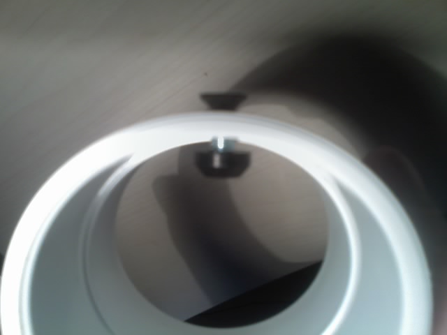

This is a very quick and preliminary method of adding hop-up to any launcher that shoots round objects like golf balls or super balls. It is a 2" cpl. with a machine screw going through it, and threaded onto the machine screw is a beveled hard rubber washer that I found in the hardware store around the bathroom faucet section. The cpl. is simply put on the end of the barrel, thus giving backspin. The screw makes it easily adjustable. To my amazement, the golf ball (that I've calculated to go over 550m at 100 psi using the equation r=[v^2/g]x[sin2theta]) did not rip off the washer. Unfortunately since I am in high school AP physics, I have no idea how to calculate the range with the backspin factored in.
- This is what she looks like.
- 10-24-09_1518.jpg (37.81 KiB) Viewed 12847 times

Might wish to put that in a metal fitting. PVC doesn't survive repeated impacts.

Yeah I fear it's only a matter of time before it tears itself apart. I'm going to try and use my neighbor's lathe and make a similar fitting out of aluminum.

A better bet is s strip of foam tape glued inside the barrel for the last couple feet. There is no impact and the side with higher friction will spin the ball. It is less likely to change the aim drastically.

Wouldn't that affect the power significantly? I could also see that getting torn out of the cannon on the first shot.
