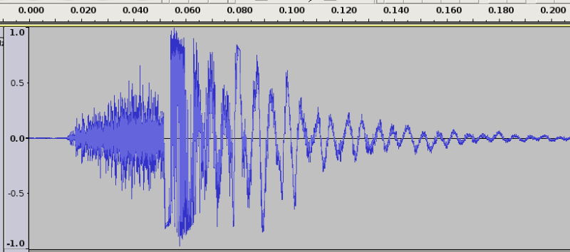

1, a really bouncy bumper. Key learning, use an impact energy absorbing bumper. Test your bumper choices by hitting them with a hammer and checking for bounce. Some materials work much better at absorbing impact. Materials used to deaden road noise in cars and in homes are excellent choices. Carpet padding, felt, etc are excellent choices.
2 A large diameter ratio between the valve seat and piston OD. A piston that opens while the pilot contains a fairly high pressure will suffer if the chamber pressure drops faster than the pilot area pressure drops. This pressure can re close the piston early. A close diameter ratio ensures the piston remains closed until most of the pilot pressure is already bled off. Too small of a pilot volume and flow restrictions between the chamber and piston make this problem worse.
With little piston bounce and little pilot area pressure when the piston pops open, the piston should be slammed hard into the bumper to remain there until most of the chamber and barrel pressure is gone, long after the projectile has left. There should be no need to trap the piston in the open position.

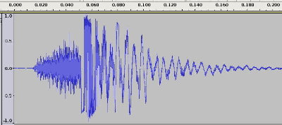

Below is a sound wave of a piston cannon discharge with no projectile. The waveform shows no sign of the air flow stopping early from a piston bounce.
Most pistons that bounce back actually bounce after the projectile leaves the barrel.

Yeah I don't know if you would really notice the difference in performance, but it would look sick if you took it apart to show someone. By the way Technician that sound wave (audacity? great program...) is a really interesting way of seeing how the air flow behaves. I might just have to try that. What kind of mic did you use to record that? [/quote]

The Mic is a studio dynamic mic that is no longer manufactured. It is a Yamaha Be100. Any good dynamic mic should work well. Avoid the condenser microphones. Many of them clip at high sound pressure levels. To prevent over recording and clipping, I used a mixing board and dialed in a lot of attenuation. I recorded near the breech so the pressure wave did not overwhelm the recording while providing good sensitivity to the hiss.AngryChauncey wrote:Yeah I don't know if you would really notice the difference in performance, but it would look sick if you took it apart to show someone. By the way Technician that sound wave (audacity? great program...) is a really interesting way of seeing how the air flow behaves. I might just have to try that. What kind of mic did you use to record that?
In short, it was recorded with a recording studio setup, not just a mic plugged into a soundcard.
