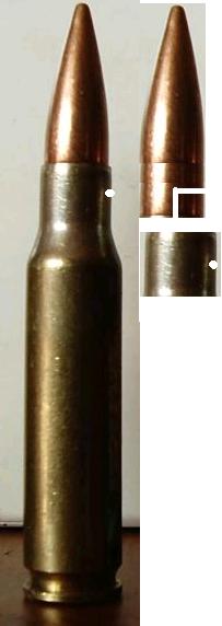

I've begun to look into this idea again, now that I can use my paintball tank as an 800 psi filling station I think a small cartridge about as big as one of these would give viable power and the possibility of automatic ejection. Using the construction methods I used in my pengun v2 they should be easy to "mass" produce too.

...with mention of the NATO ammunition and all, got me thinking. Along the hybrid cartridge concept, what if you used a NATO cartridge? How do you get the fuel/oxy in there? Similar to a spool valve, the bullet would be used as the spool valve core. With the bullet 1/2 in the cartridge the valve would align, fully load the bullet and the valve would seal. Not sure the compression bullets have against there cartridge, but I suspect you'd get double digit mixes.

I'm actually considering using a 7.62x51 cartridge, I have a couple of empties lying around :D not much success with a pressurised hybrid on a tiny scale from my part though :(

jackssmirkingrevenge wrote:I'm actually considering using a 7.62x51 cartridge, I have a couple of empties lying around :D not much success with a pressurised hybrid on a tiny scale from my part though :(
To bad you are not in my area.
I could offer about 200 cartridges of .243 and .308 caliber.
Basically the same brass. The .243 is necked down.
Shame :( I'm wondering if they have enough volume for a 0.22 projectile though. They would certainly be ideal for a 3mm calibre cartridge but I'm not sure if going that low is worthwhile.
