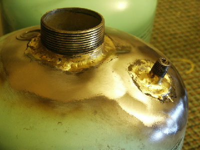

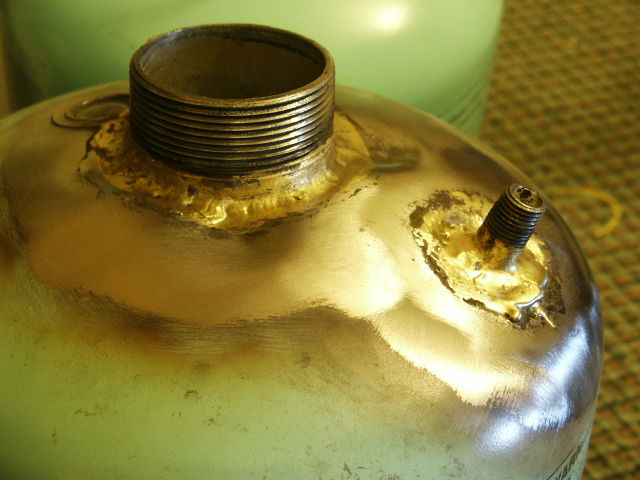

Brazing with a torch and a flux coated brazing rod comes to mind.
This IS how the copper tube goes through the steel case of a refrigerator compressor shell.

Not to pick on anyone, but just to educate the general public.
Brazing is a high temperature soldering type process where two pieces of metal the same or different are joined with a 3rd metal to bind them together without melting either. Due to the copper/iron joint, it can't be welded, but it can be brazed. Most brazing is for joining dissimilar metals or metals of vastly differing thickness where welding would melt one away.
Welding is the melting of two pieces of the same metal with or without a filler of the same material. Most welding is in the iron and steel family of metals.Is there a reason why you haven't already decided on welding?

???but I'm not sure the applied heat wouldn't just remelt the joint.
you just heat the metal until it cherry red, then you apply the braze. when you are done you just let it sit until its cool.
Are you worried about when you use steam and heat it up? water boils at 212 degrees, its going to take around 1000 degrees to melt the braze. it melts a lot hotter than solder.
the mythbusters made a steam gun and used regular solder and didnt have a problem. like i said, the braze has to be bright cherry red to melt it.
