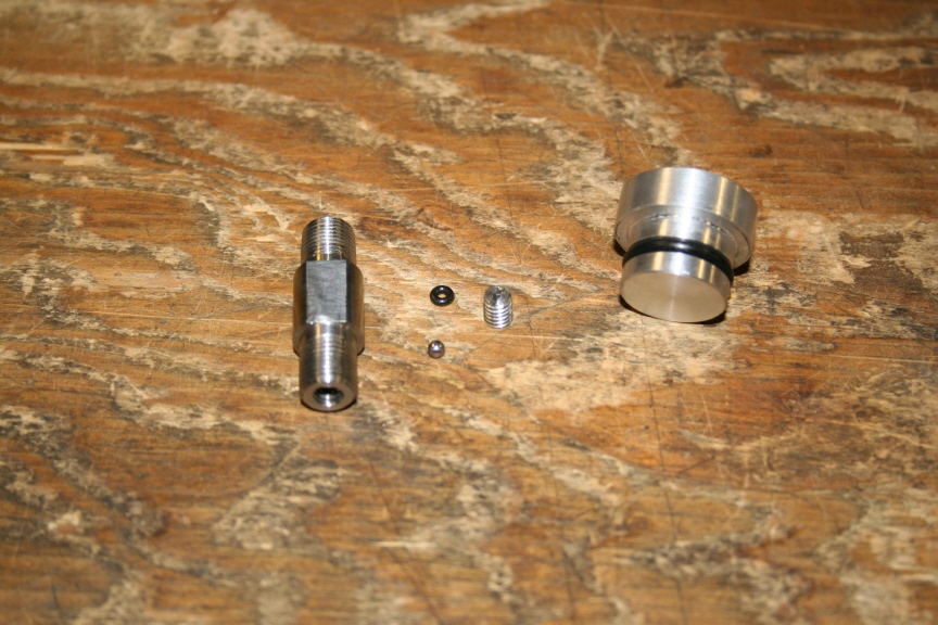

And a pic of one of the checks I built. It's good to 9000psi.
No spring in this one, it relies on orientation to initiate the seal. The small threaded piece is drilled out to provide travel for the ball, and it also holds the o-ring in place under flow conditions.

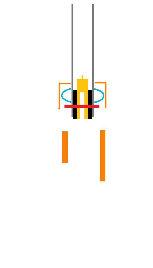

That's it. I'm finally going to get off my bum and share my gift with the world. The schrader valve used as a check valve for a stirrup or shock pump. With a pump that has 1/2'' tubing, just grind the bulk of the rubber but keep enough so that it will make an air tight seal with the tubing. Next is to fix it in place with the tubing. I drilled a small hole through the tube and valve about 10mm from the bottom (Absolutely make sure you don't drill through the pin of the schrader) and inserted a hardened steel nail to keep it in place.Keep enough nail on both sides of the tube to allow a compression olive to be kept in place and not slide. This prevents a blow out of both the schrader valve and the tube at very high pressures.
I found this was the best, easiest and cheapest way to make a good pump check valve. With the pump cylinder being held in place by brass compression and threaded fittings, it's very easy adapt the pump into a gun, hose, gauge....whatever really...
