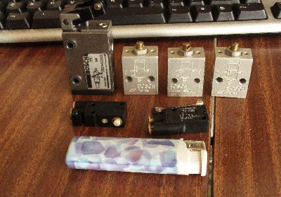

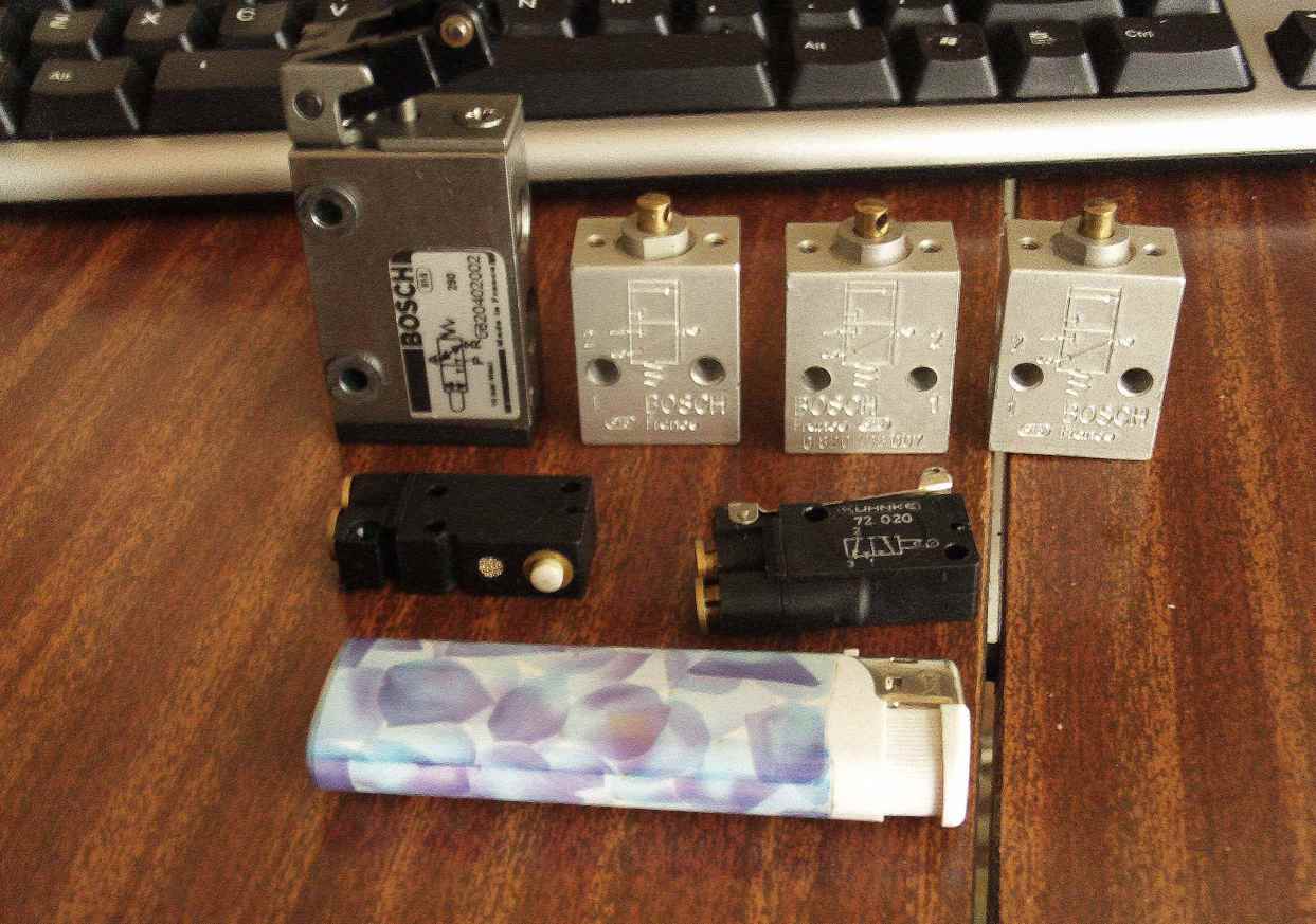

look what I've got for 10PLN (~3.6$)
bought off a site similar to ebay
lighter is for scale
look what I've got(directional flow control valves)vid added

Weird. We use it for cigarettesPOLAND_SPUD wrote:lighter is for scale
Good buy

there are several things I like about them...First off all, they are really really small but offer quite a lot of flow... they would make great triggers
now I can put the trigger anywhere I want to and use 4mm tubing and a small QEV to pilot the main valve
I've just tested a simple circuit with one of them and a single acting air cylinder...
here is how it works->
the rod of the cylinder triggers the valve when its retracted... as it extends the air source is shut off and the cylinder is vented... spring returns it back to the starting position and the whole cycle continues
it's interesting to see how fast an air cylinder can cycle with one of them...
(you can also see push-to-connect fitting and tubing there ( 4mm OD X 2mm ID polyamide tube, rated to 50 bar
) ...they are really useful - you can assemble a circuit with them in a couple of seconds...

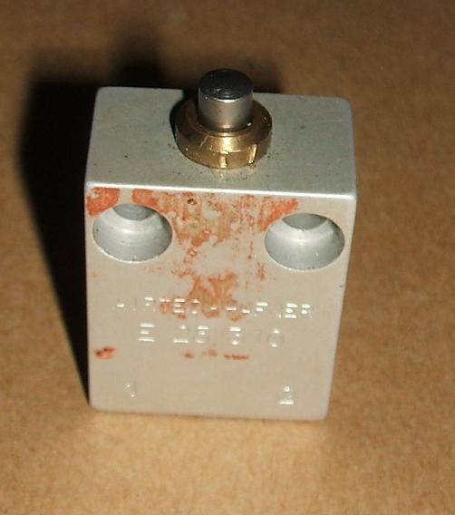

but I've used the metal ones at about 350psi and they worked fine
but the two with plastic bodies are rated to 8 bar... they can handle more because they are really small but I wouldn't like to have them close to my face when pressurised to 400 psi
