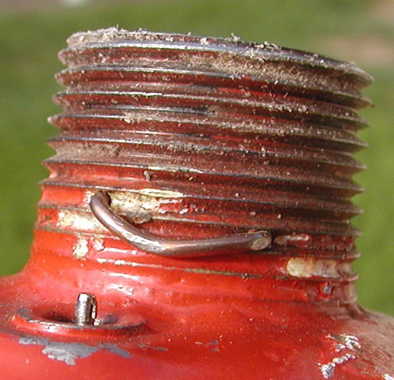

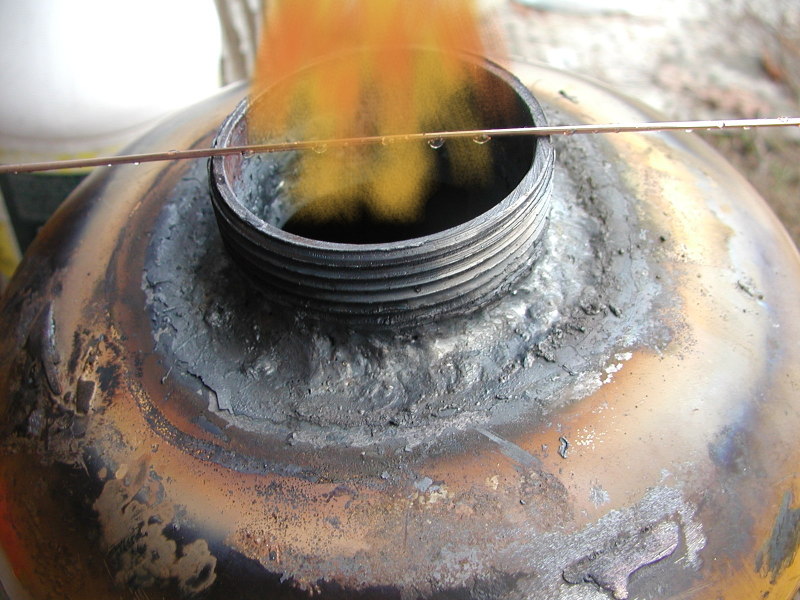

sorry for the double post but hope th pics of the bottle helps
The bottle now
top of the bottle (i know its messy weld but it holds
and i grind ed the weird bits off)
Steel bit that was welded on (this was the off cut, with a thread on the opposite side and my steel bit was obviously shorter)
the top look of it bottle (you can see where the hole was drilled through and the little thingie on the side is a inbuilt shrader used for refilling but i can use it cos it needs an adapter)
hope these helps
