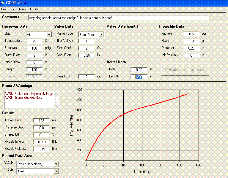

jackssmirkingrevenge wrote:Depends how long you're prepared to make your barrel ;)
Thanks for the GGDT prediction.
My question was about what was actually shot and recorded.

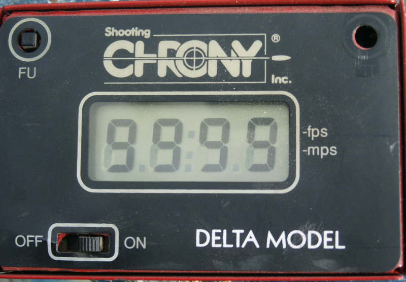

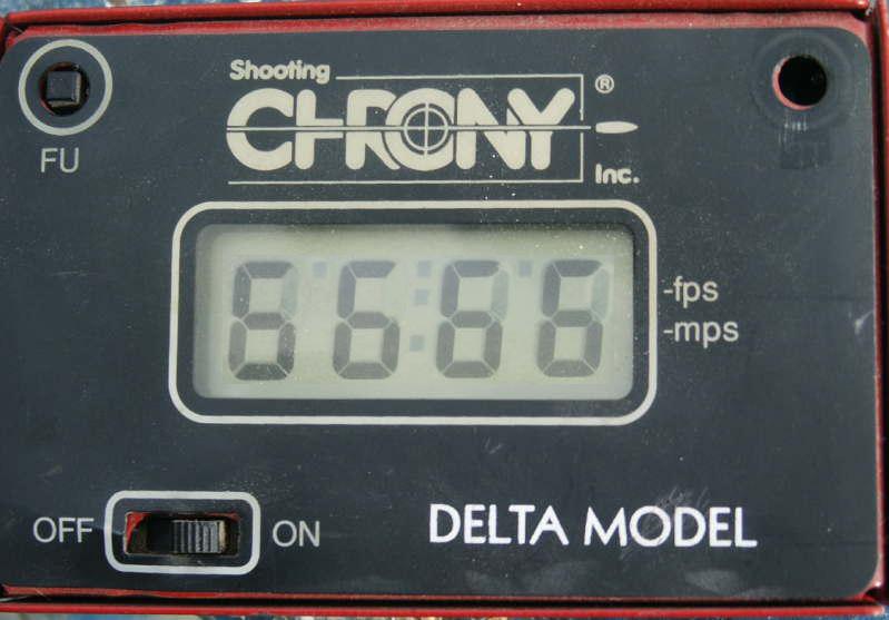

I may have cheated...
Definitely not photoshopped
Definitely not...
jackssmirkingrevenge wrote:Definitely not...
LOL.. I had to look at that one twice to notice the decimal points are on the top.. :D
Technician1002 wrote:LOL.. I had to look at that one twice to notice the decimal points are on the top.. :D
Yeah, I could have made a better job but believe it or not I actually have better things to do :P :D

boyntonstu wrote:What is the lowest pressure that has been used to propel a projectile weighing at least 25 grains beyond the SOS?
In a pneumatic using air... I have no idea.
There are few claims of supersonic pneumatics I believe. And most of those are air rifles. So few have fired projectiles of that weight, or have used other gases.
People need to get it out of their head that SOS in a pneumatic is something that happens easily. GGDT is far too generous in the number of 1100+ fps numbers it churns out.
Indeed, the way I've got Apocalypse set up means it won't give a supersonic velocity in Zero-D single stage modelling, where the maximum conceivable output is Mach 1 (and it'll only give that under ideal circumstances).
It's only when the modelling is changed to pseudo two stage (ideally, One-D), that supersonic velocities can happen at all, and it's still a veritable nightmare to actually coax such a number out of it, taking a lot of finely tuned numbers and no small amount of pressure.
I would go to Apocalypse now and actually do some of the numbers - but all of that stuff is on my laptop, which... you guessed it... is still in servicing.
Anyway, as something of an answer, the pressure required will vary so wildly with launcher design that actually giving you a number would be moot.
Also, whether or not you have the theoretical potential, practical achievablity will vary massively with barrel length, calibre and projectile mass (Imagine someone asking "what pressure is needed for my launcher to do 700 fps" with no more information present).
Whatever the exact answer, it will not be low. It takes a lot of pressure even with something designed for it.
