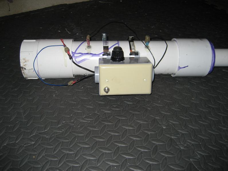

I finished my first cannon, and it looks kind of ghetto. I wanted to see if you guys had any suggestions for improvements.
Currently:
Inline spray and pray launcher
3''x14'' to 1.5''x60'' (C:B .85:1)

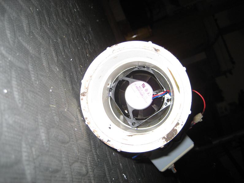

3'' computer fan
BBQ Sparker
Chamber-Short for two gaps
Going to add:
Going to redo the wiring - aesthetics

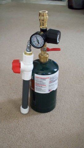

Ball-Valve for easy venting
Propane...via Schrader valve
Propane Meter that is a side component.
I had a hard time getting the wires to stay put in the inserts..so I epoxied them in place. Another limitation I had was with the size of the sparker. It's hard to make something that big look nice.
Attached are the pictures. Thanks for the suggestions.

holy crap that is a big sparker ! could you maybe take the components out & install then into a smaller box? i use the same exact metering setup that you do .i just drilled , tapped another female quick connect into my chamber but with a 90 degree elbow so it lays flat against the chamber ,, also a paint job goes a long was for looks
Lol. The size of the sparker was my biggest problem..but it runs off of one aa battery, and can throw down some good sparks.
I thinking that I will do away with the box, and hide everything in a handle I make...it will cover all of the wires. Then, when I paint it..it will look awesome.
If you're gonna make a handle, make it so everything can fit in there, and hide all the electrodes under the tee/saddle. Also instead of strapping it on, just use 2 nice wood screws.
If you decide to use a box, get a smaller one from Radio Shack and mount it with 2 machine screws in the bottom of the box through the chamber wall. Giant hose clamps - or any for that matter - are ugly. Here's the fun part: Send your fan power through those 2 screws to eliminate visible wires. I suppose you could actually do that with the spark leads too.
Be sure to use crimp-on connectors to keep the leads in good contact with the screws.
Plug the old lead holes with small screws. Make on of them into your propane injection port. Hide one or 2 more by mounting the box so it hangs over it.
Paint it.
Paint it.

People seem to live by that double layer rule, but throughout my adventures, I've found that a well-drilled and tapped hole through a single layer is nothing at all to worry about. When practical, I will mount anything I can through a double layer, but when ergonomics or even aesthetics come into play and suggest for a different positioning, I find that those parts mounted through a single layer can be more than secure enough for everyday use if done right.

Of course it's possible with some designs, and it's good practice.
I've seen failures, but actually none because of single-layer drilling. I've actually had chambers crack in cold weather - nowhere near the holes! Luck maybe?

That is the idea.If you're gonna make a handle, make it so everything can fit in there, and hide all the electrodes under the tee/saddle. Also instead of strapping it on, just use 2 nice wood screws.
Can't do that. The box I'm using is the smallest I could find that would work. Besides, I am going to put everything in a handle.If you decide to use a box, get a smaller one from Radio Shack and mount it with 2 machine screws in the bottom of the box through the chamber wall. Giant hose clamps - or any for that matter - are ugly. Here's the fun part: Send your fan power through those 2 screws to eliminate visible wires. I suppose you could actually do that with the spark leads too.
That is what I am using.Be sure to use crimp-on connectors to keep the leads in good contact with the screws.
Took me a second to understand what you were saying. But, no. I am going to put my propane injection by my fan, through two layers. I am thinking of doing away with the box..it's really ugly.Plug the old lead holes with small screws. Make on of them into your propane injection port. Hide one or 2 more by mounting the box so it hangs over it.
Yes. Maybe an olive green, with black lettering.Paint it.
The only thing that is not tapped through double layer is my spark electrodes. I didn't put them through double layer because I have them set on even spacing through the chamber. We seem kind of split on the double layer thing. I understand that you can never be too safe. As a first edition, if it fails, no biggy. I'll learn my lesson, and take what I can.
