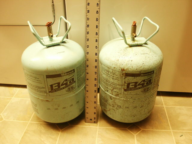

I recently realized that the old helium tank I have lying around would make a great pressure vessel. But as far as I can tell, the helium inside was only at a few atm of pressure, so I wonder how much a tank like this can safely take? I plan to hydro test it before using it for anything, and this raises the question of the water potentially damaging the metal since the inside of the tank isn't designed to contact anything except nonreactive helium. The metal is about 1/10 inch thick, based on a rough measurement of the depth of a preliminary hole I drilled, visible in the picture. I plan to have two holes of slightly larger size on opposite sides of the tank, and tap in 1/4" NPT threads as soon as my tap arrives from McMaster. I realize that will give me little flow, but for my purposes that's ok.
So to summarize, will this take a decent amount of pressure? And will filling it with water be a problem? Thanks.

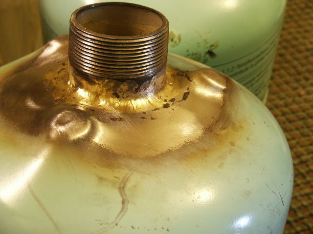

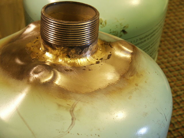

I used a Freon tank of much the same construction for my competition t shirt launcher. They are too thin to weld. They do braze OK. I use mine up to 100 PSI. They do have a burst disk for overpressure protection.
Disposable Freon tank with 2 inch valve brazed into place.
Helium tanks and Freon tanks are in the same family of construction.
