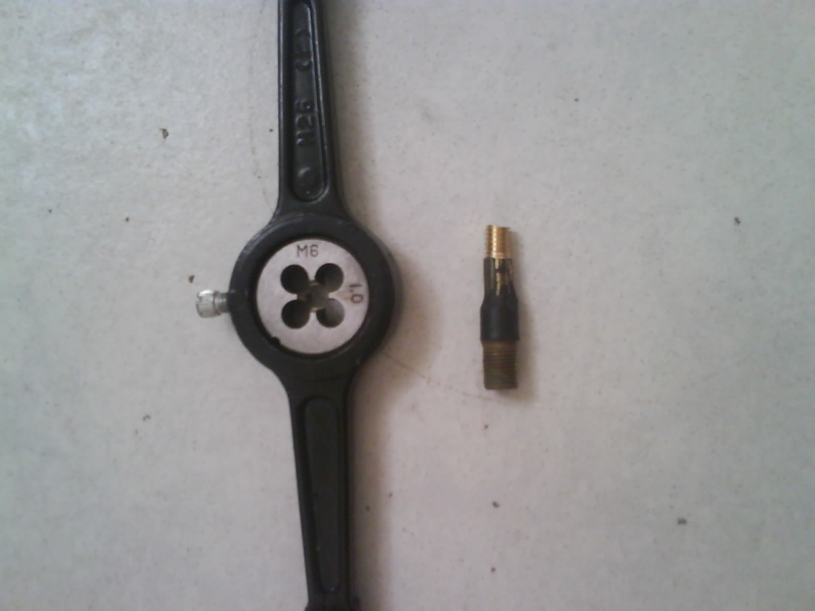

1 what kind of m6 thread did you use there are two common types the M6X1 and M6X0.75john bunsenburner wrote:
1 As i have a free source of these i would like to find a way to use them (for cartridges), the problem is that threading the stem renders the entire valve useless, the walls are simply too thin for either a m5 or m6 thread, while the diameter is too small to allow for m7 threads.
2 Now where do you think i could find a tap that would cut the internal threads with the previously mentioned measurements.
3 I guess if worst comes to worst i either insert the valve stems into molten metal that is then threaded and screwed in somewhere,!
I have also found that the M6X1 cuts the threads too deep and renders the valve useless but the M6X0.75 worked pretty good in the past for me
I attached a pic of my experiment to determine what thread size would work. I had to look for myself and my conclusion was that the M6X0.75 would do for the valve and the M6X1 cuts almost through the casing. So I think the M6X0.75 would work fine except maybe in very high pressure situations
2 you would most likely find that tap in a specialty tool store
3 what metal do you plan to use? aluminum wont work copper based alloys dissolves quickly in aluminum and lead is too soft tin would solder itself onto the valve in general I would say this is a bad Idea
