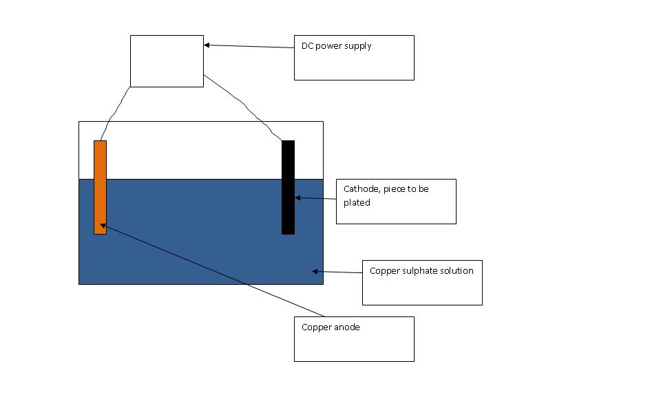

Here goes chemistry class:
To electroplate you need metal ions in solution that are positively charged (copper has a +2 charge, nickel does too, but there are exceptions) cations (as they are attracted to the cathode). Now to electroplate these ions have electrons forced onto them, two electrons in this case, the ions will then have no charge and change into solid metal which will, if done correctly, attach to your anode, the part to be plated. Now any ionic copper compound would, technically, do the job. For teaching purposes I will use copper sulphate, which in solution has a blue colour it is also fairly soluble and so good for these purposes.
You first make a solution which should be saturated with CuSO<sub>4</sub> (Copper Sulphate), at standard room temperature that is 31.6g. I could now work out how much of those 31.6g are copper, but that is of little use to you, what you should, however, know is that slowly the copper will be used up. To prevent that you use a copper anode, this will “pull” away two electrons from the copper thus release more copper into solution, like this you will never run out, technically if the anode is replaced before being used up. Your set up should look like in the attachment.
In practice you are faced with the problem that copper will not bond well to the piece, this can be improved by using cyanide based solvents(instead of water) but doing that at home, without a commercial set(which can get expensive) is asking for trouble. You can buy kits to do this, but if you only want to do this once or twice have your piece commercially plated, there are companies that do this and it will be cheaper than buying a kit and then only using it once.
- electroplating.jpg (26.07 KiB) Viewed 7858 times
