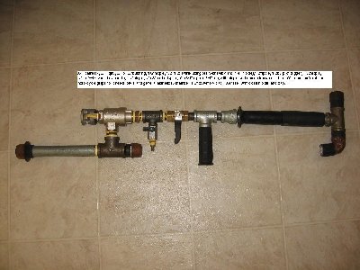

to coin a phrase, "It's a High Pressure Rifle So simple a Caveman could build it"...
I basicaslly wanted a shoulder fired version of the mini modgun that would enable heavier and larger bore projectiles to be launched using hipressure/lowvolume with performance exceeding hivvolume/low pressure pvc chambered cannons, and It works very well in that aspect, It is only about 10% down on performance from DD1 and it's 10ft barrel when I use a 36" barrel on it..

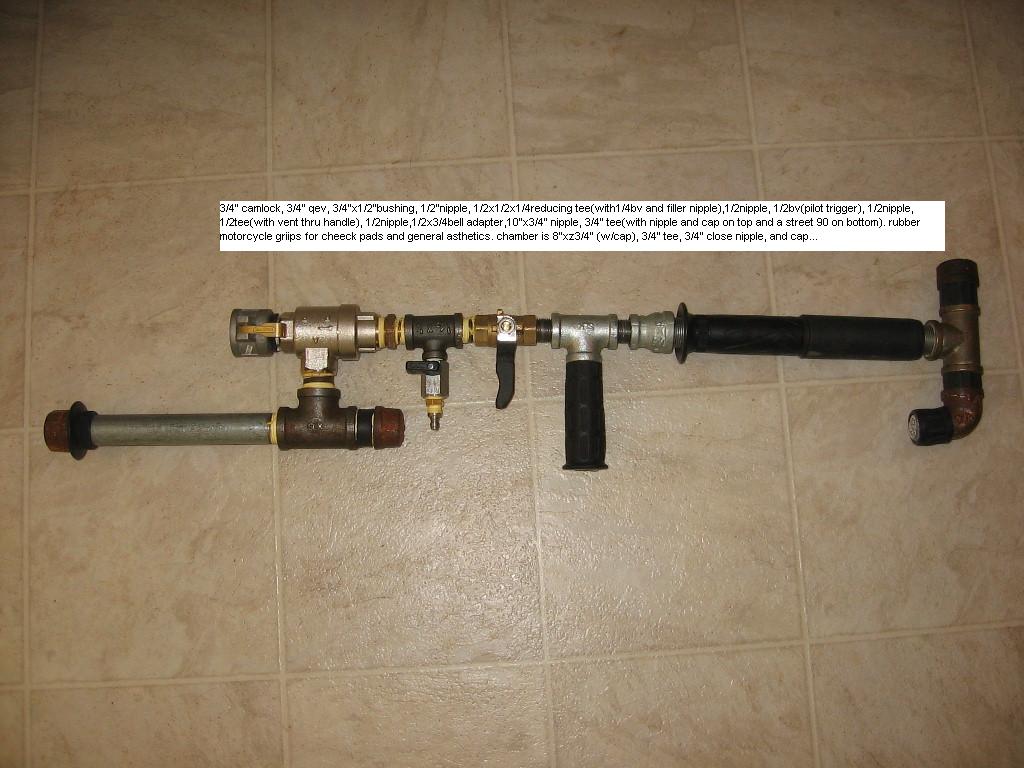

No barrel is shown in the pic, but it has a complete parts list in the pic...
It'll use any of my mini modgun barrels, as well as a 1 1/4"x36" barrel I made for it, a GB barrel I made for it, a TB barrel I made for it...
I've shot it prolly 100+ times with 750psi, and even with 6oz projectiles in the 1 1/4" PVC barrel, the barrel survives fine(but only because the barrel pressure doesn't rise fast enough to be beyond safety limits)...
With the GB barrel(36"of sdr21) I'm chronying at 720+fps..
TB barrel(28") is around 480fps...
I DO NOT recommend using PLASTIC CAMLOCKS, And would be careful with pvc barrels( depending on the diameter of the barrel the projectile only has to move a few inches to prevent catastrophic barrel failure, but if it jams before that, it could get ugly)....
Caveman simple HiPressure rifle...

nice but I think you could choose a more compact design (i.e. the main valve closer to your shoulder, thus allowing for barrel length for the same overall length)
That one is in the works... It'll use copper construction and a cable actuated bv to pilot it... This was meant to be cheap, easy, and a means to test hipress/lowvolume/smallish porting with larger diameter barrels and heavier projectiles without putting undo recoil stress on elbows or tees...POLAND_SPUD wrote:nice but I think you could choose a more compact design (i.e. the main valve closer to your shoulder, thus allowing for barrel length for the same overall length)
Besides, do you want a pvc barrel beside YOUR head when you are slamming 750psi into it???
As a Note on price and assembly time:
3/4" qev $20
1/2" ballvalve $6
3/4" ally camlock $8
1/4"ballvalve $5
nipples and ftgs $18
Total cost, w/o barrel= $57, Time to assemble 15 minutes Max....
For a 750+psi capable cannon, not a bad investment, plus it shows that It doesn't take rocket science or major fabrication skills to build a VERY Powerful Launcher...

ohh I see... I've built lots of such guns in the past... they give you the most fun out of spuddingThis was meant to be cheap, easy
but I prefer to have the QEV exhaust port at 90 deg to the barrel... normally I just use a T to join them: one port of the T is attached to the barrel one to the QEV and the one facing the shoulder is where I screw in a blocked off nipple... then I attached another T there to serve as a buttstock
in this way the recoil acts directly on your shoulder.. piloitng might not be as comfortable as in your design but I think that I'll buy a small QEV to assist piloting so that I could put the trigger where I want to and I advise you to do the same
I have to admit that I used a DWV barrel on a similar gun (but only 1/2" porting, 1.5" barrel @ 500 psi)pvc barrel beside YOUR head
but a couple of days ago I found a some 1" aluminium tubes and they are really really light.. have you considered switching to alu ? I know it might be difficult to find alu tubes in larger sizes and cheap enough but they would be ideal for a gun like this
I've never been a big fan of bends in barrels... I am going to modify slightly to reduce wasted pilot volume by switching to a male run tee off the qev, and a male fitted bv... will reduce the pilot volume about an inch^3
