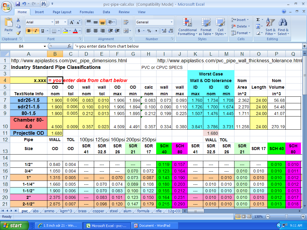

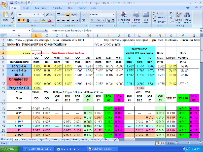

CS and Tech;
This may clear up the dimensional differences and terminology used.
SDR-21 has 200 psi rating, hence the name "class 200".
SDR-26 has 160 psi rating. May be considered a class 160?
Note 1.680 is minimum golfball diameter.
If any one would like the spreadsheet let me know.
This is correct.dewey-1 wrote:CS and Tech;
SDR-21 has 200 psi rating, hene the name "class 200".
SDR-21 = 200 psi rating = 'Class 200'
SDR-26 = 160 psi rating = 'Class 160'
SDR-41 = 100 psi rating = 'Class 100'
