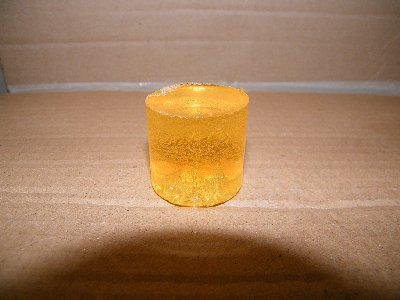

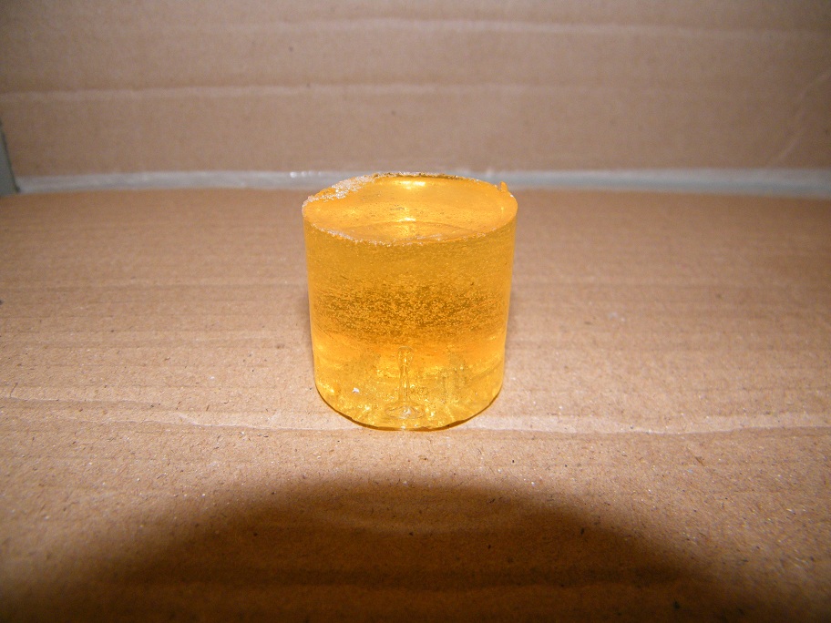

Dried epoxy piston which I will lathe tomorrow to fit the insiide diameter of the brass tee and also have an O-ring groove to seal inside the copper adapter.

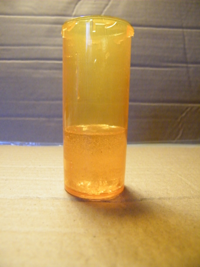

Epoxy piston mold. Old pill bottle.

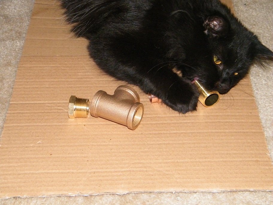

My cat Carlton who likes to help me put the pieces in the correct firing order for high pressure sealing!

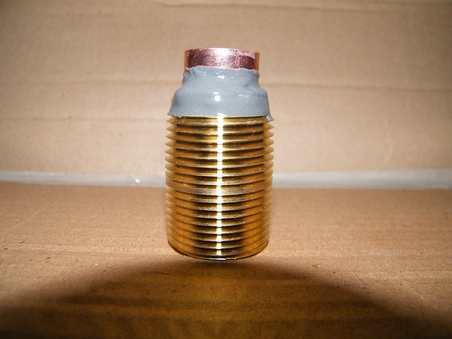

The copper male adapter JB Welded inside of the brass nipple because it made a nice fit and provides a good surface for the inner barrel O-ring seal I will make.

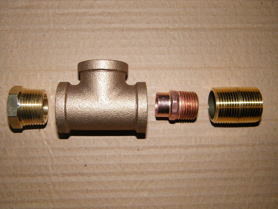

This is the general layout for the valve. From left to right it's a 1/2" to 3/4" bushing, 3/4" tee, 1/2" copper male adapter which will be JB'ed inside the last piece which is a 3/4" nipple.

[quote]I will lathe tomorrow to fit the insiide diameter of the brass tee and also have an O-ring groove to seal inside the copper adapter.
[quote]
you need a sealing face to seal to the barrel piece or thas how ive done it
what epoxy u using?
oh by the way looks nice so far
dont play with airsofter with 1000$ gun and play with a 5 dollar pair of glasses
spudkpi
Posts: 135
Joined: Tue Aug 01, 2006 8:52 pm
The epoxy is West Systems Marine Epoxy and am going to throw it on the lathe so it will have a neoprene sealing face and a section that will seal inside the barrel also with an O-ring. Not sure on the pressure yet. Hopefully I can finish the piston tomorrow and get the system running for some tests
