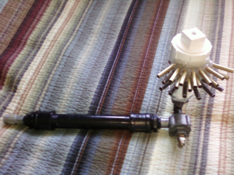

A few friends and I started to get back into airsoft, and since I haven't built many launchers lately I decided to tackle a claymore. It turned out much better than I expected, although it's not much to look at. I haven't painted the whole thing yet, but I plan on painting it all black. I forgot to take pictures of them, but I made a few stakes to hold it in place and keep it from falling over when it is triggered.
It uses fairly low pressure so that it doesn't hurt anyone. I have not chrono'd it yet, but I'm expecting it to shoot around 100-150 FPS.

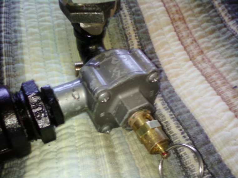

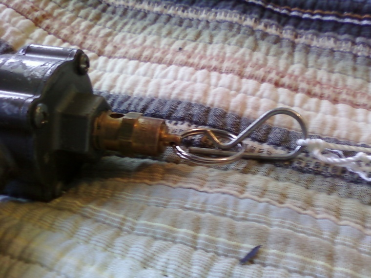

The valve is a 1/4" QEV.
The QEV is piloted by a safety relief valve, which is pulled by a string. One end of the string is attached to the pop-off valve, and the other end can be tied to a stake in the ground so that it is held over a path where enemy team members are expected to walk.
The string is tied to a cotter pin so that when the string is pulled hard it will pilot the QEV, but at the same time it will disconnect from the pop-off so that it doesn't trip anyone or pull the claymore out of the ground.

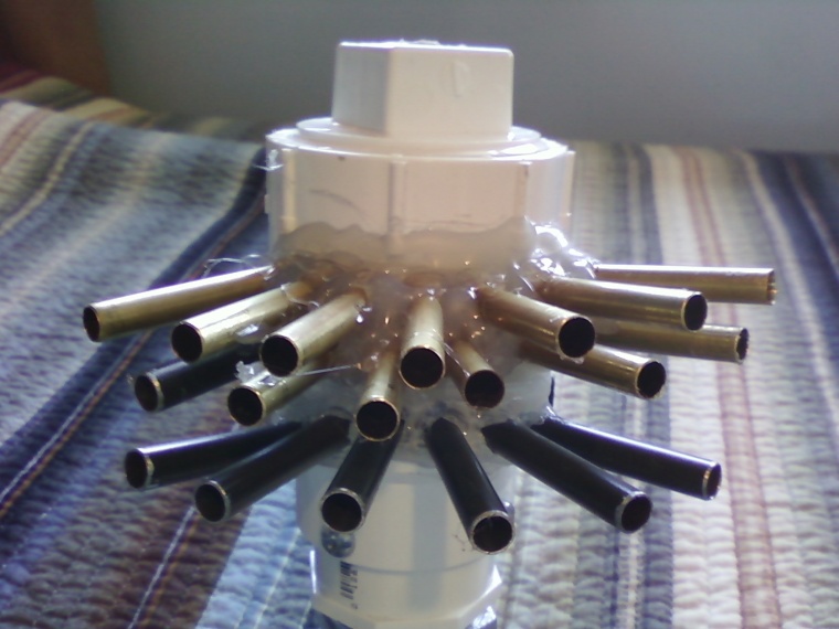

There are 19 barrels, all pointed in slightly different directions.
It works a lot better than I expected it to, but there are still a few changes that need to be made. As I mentioned earlier it needs paint. I will also replace the white string with fishing line so that it is harder to see.

haha excellent, looks like a pain to reload though
with a bit of paint it will be hard to spot in a woodland setting.

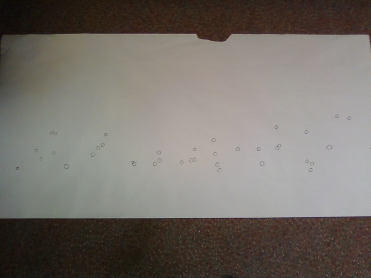

Did you try firing it at a few sheets of cardboard to see the spread?

I shot it a few times in my basement, and the spread was pretty decent. It is a 90* angle from the far left barrel to the far right barrel, so it should be more than enough. I'll have to find some cardboard and check it out though.
It's not too bad to reload, just drop a few pellets in each barrel and then fill it with air again.
It is much easier to reload than the other design I tested which used a spring loaded spike to puncture a burst disc.

My biggest concern is the tripwire. Number 1, it is too low to the ground. It should sit 3 to 4 inches from the ground to have the best effect. Number 2, it may need to be pulled a little harder than what you would want in order to trigger it. This may lead to persons falling over and getting hurt. I know you said that it is designed so that the string will slide off, but it will still take a little bit more pressure to do.*
A safety shouldn't be that hard to implement. You could probably just slide a cotter pin into the popoff valve in between the spring.

The pop-off valve is very easy to trigger, and it only gets easier at higher pressures. It is designed to open by itself at 125 PSI, so opening it at 100 is no problem at all. I have triggered it myself walking and running to make sure that the cord is not a hazard and to make sure that the velocity is fairly low, and before I could really even feel the trip wire the mine had gone off and the wire had disconnected.

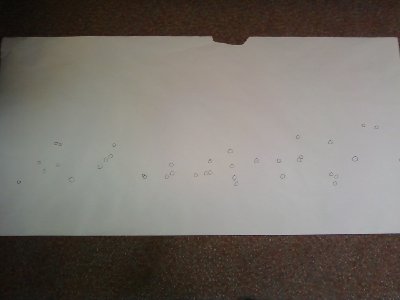

I also tested the spread today. This piece of paper is about 5 feet wide. The mine was set up about 3 feet away from the paper. The shot was with two bbs per barrel @100 PSI.

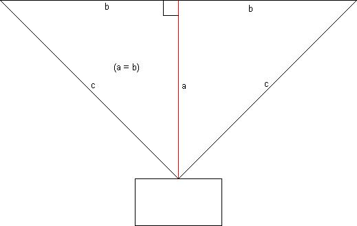

Well, then. Looks like you have yourself a very nice airsoft mine. The only thing left for me to advise is the V shaped tripwire, to provide even more coverage.

And here's how I determine the length of the string needed for the tripwire:
- I set the mine off at least three times to get an average maximum distance. I only plan on using 90% of this average distance to ensure that I get a 'kill' if the tripwire is hit.
- I measure straight out, from the mine, this distance and place a mark. At a right angle, I measure this same distance and place another mark (the second mark should be at a 45 degree angle to the mine). I repeat for the opposite side of the first mark.
- With the lengths of two sides, I use Pythagorean Theorem (or measure, whatever - I like math...)to determine the distance between the last mark and the mine.
- I add up the lengths, and that is the length of my tripline for V configuration.
Example: I receive an average maximum distance of 10 feet, therefore, I measure 9 feet (90% of 10) out perpendicular from the mine. At the end of this point, I go 9 feet in both directions and place two more points. I use math to determine the final lengths, so 9^2 + 9^2 = 162; SQRT162 = 12.72. This leaves me with 18 + 12.72 + 12.72 = 43.44 feet needed for tripwire.
