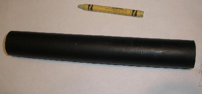

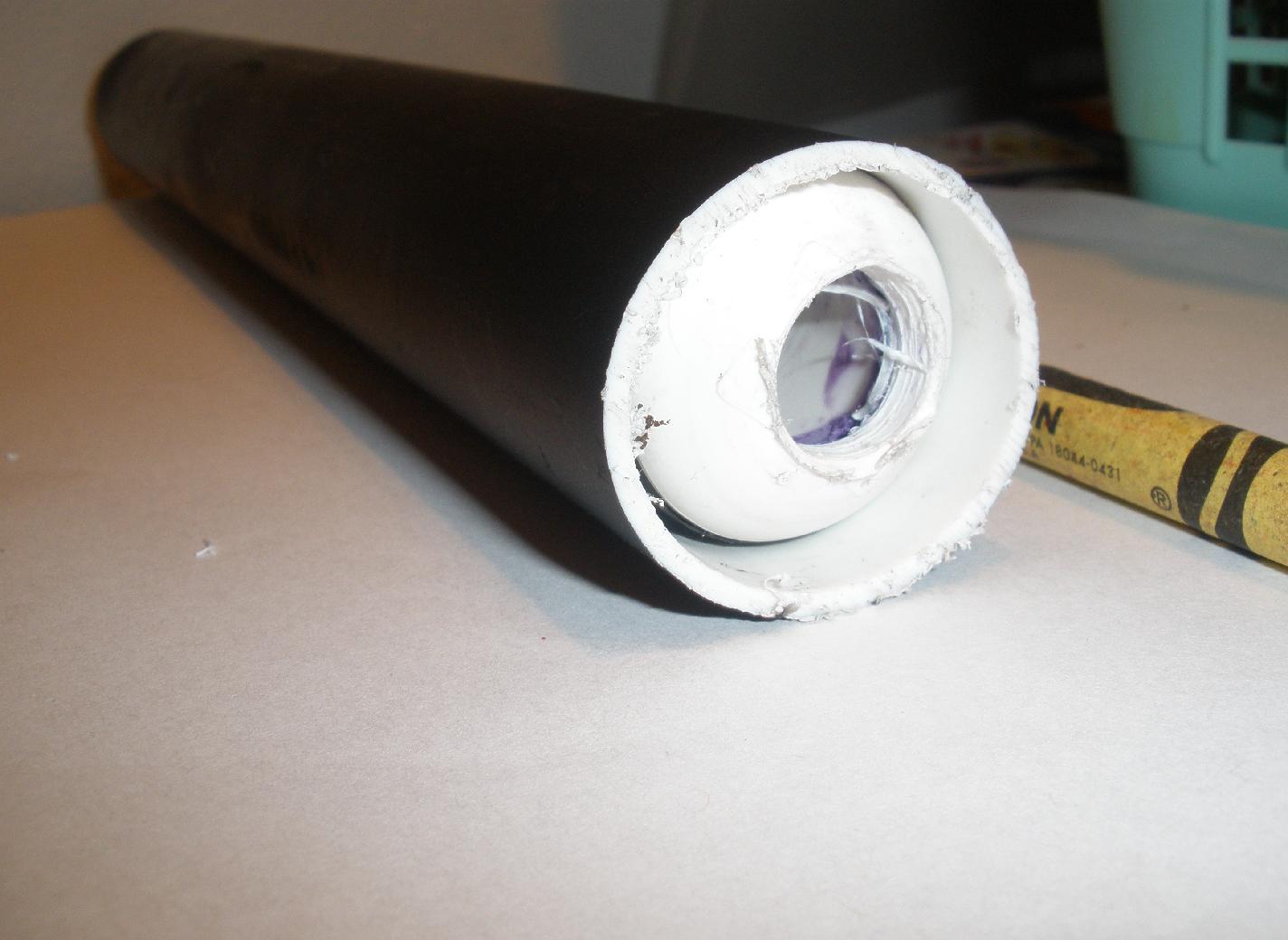

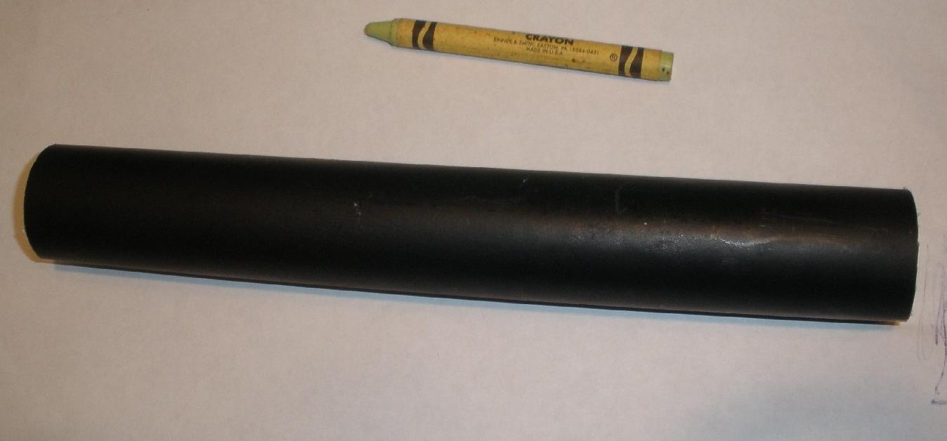

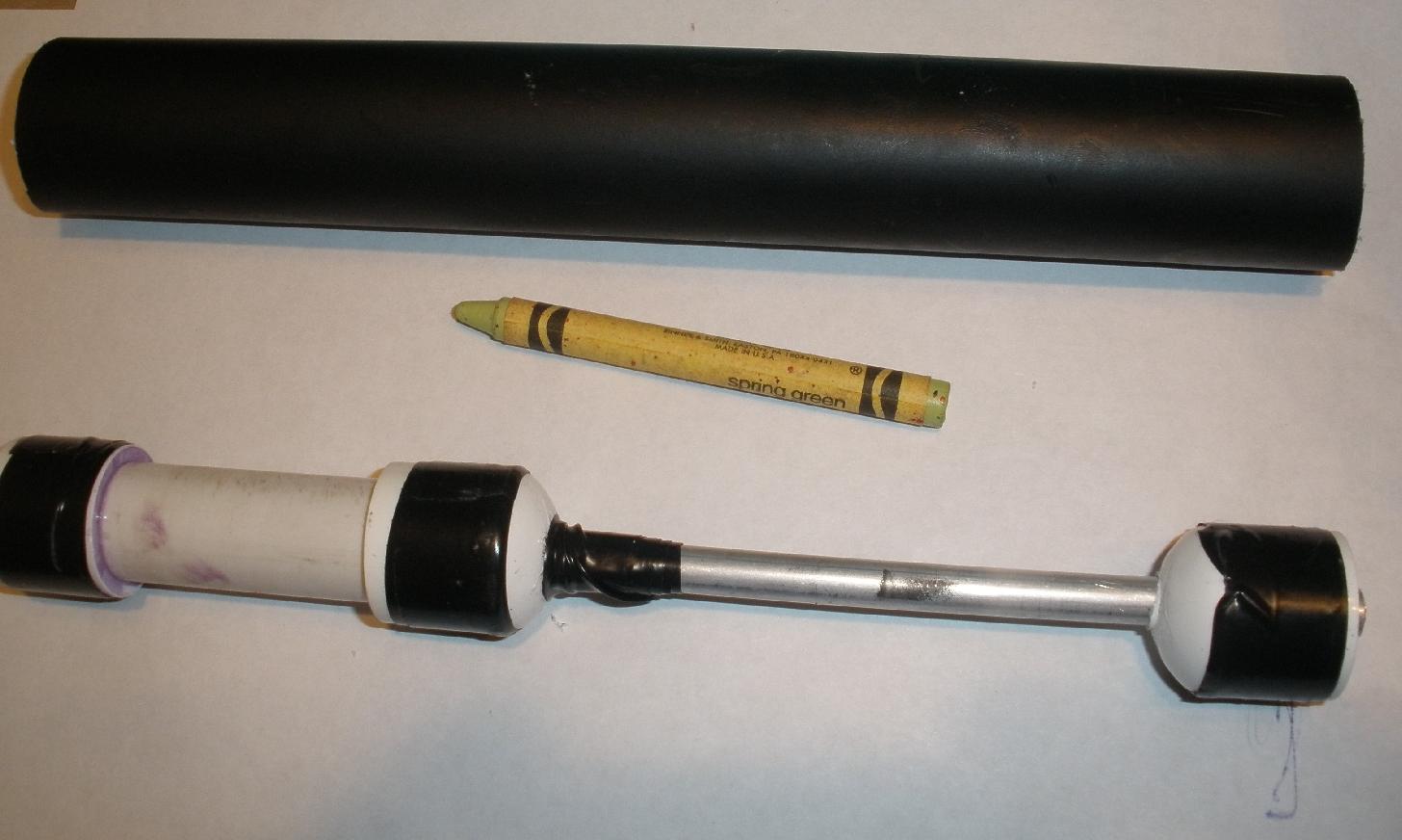

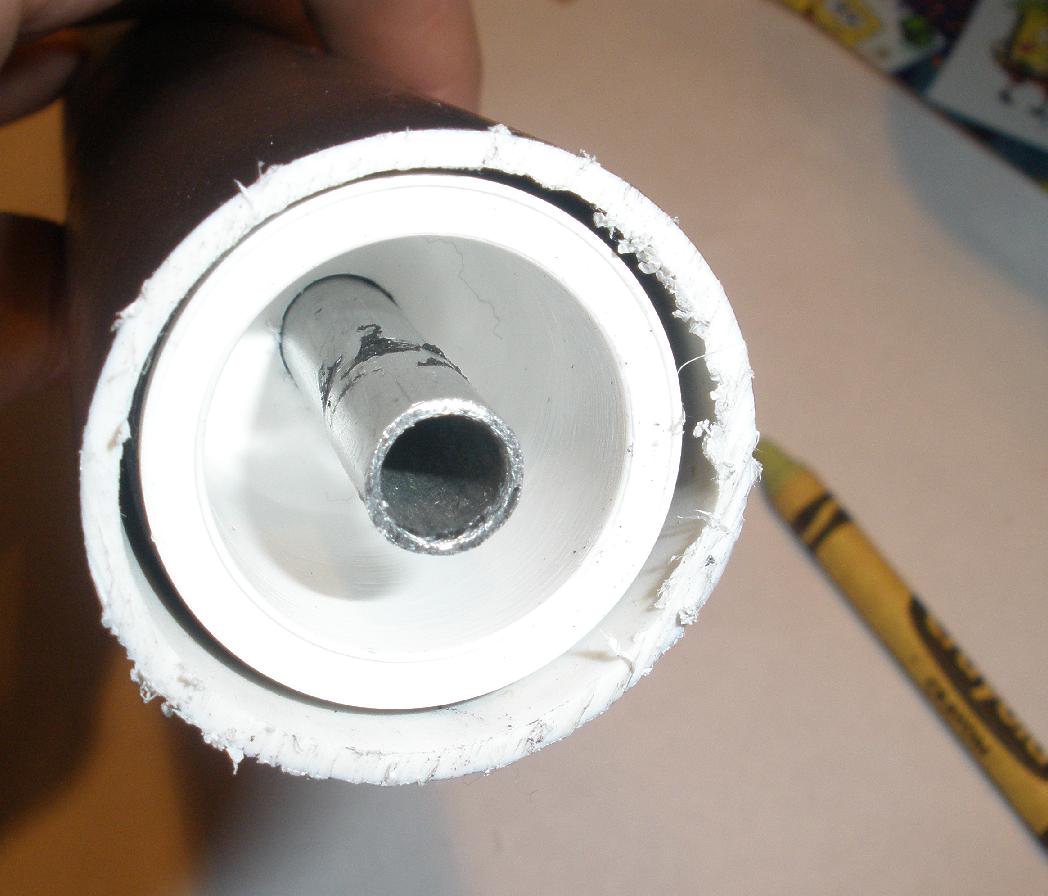

I'm building a full auto pistol for airsoft. So far i made the whole cloud bbmg setup but without the trigger/ air source thing. I will be using a co2 tire filler for this. I'm just posting this to see if you guys have any suggestions before i finish.

um just a warning ive heard that the co2 tire filler only last 3 seconds with each cartridge
- Brian the brain
- Posts: 3497
- Location: Holland
- Been thanked: 7 times
I'd be more worried about the freezing 800 to 900 psi coming out in those few seconds.
It will be enough to blow up the bbmg in case of a jam...and just to make sure it will make the PVC brittle with the extreme cold at the same time.
You'd be better off with metal..
I've been testing the gun with a co2 inflator. It failed. all i got was about 4 good seconds of air flow and it couldn't penetrate cardboard. i'll have to get a better idea.clemsonguy1125 wrote:um just a warning ive heard that the co2 tire filler only last 3 seconds with each cartridge
