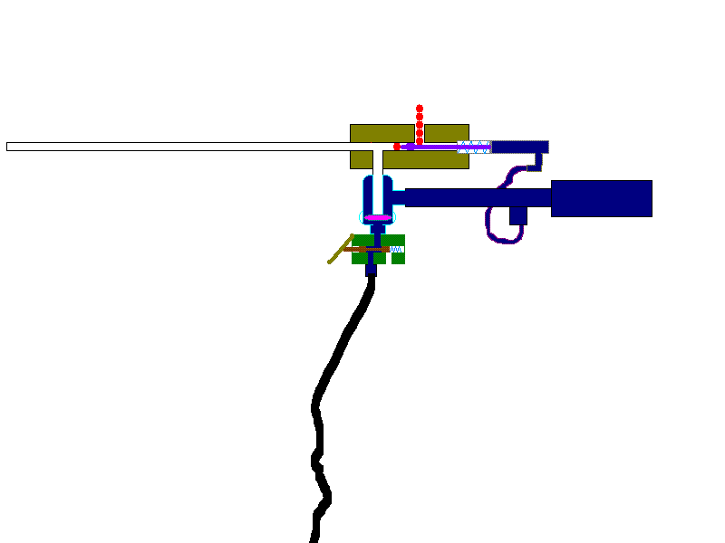

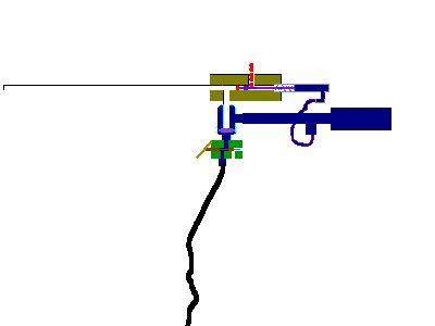

This is the 3rd version of my semiauto pneumatic
It operates exactly like MK I and MK II:
The air cylinder is hooked up to the chamber and it extended when the chamebr is pressurised. When you pull the trigger (actuate the 3 way valve) the QEV fires and the cylinder retracts and takes one round from the magazine and loads it as soon as the trigger is depressed. That's basically the whole cycle

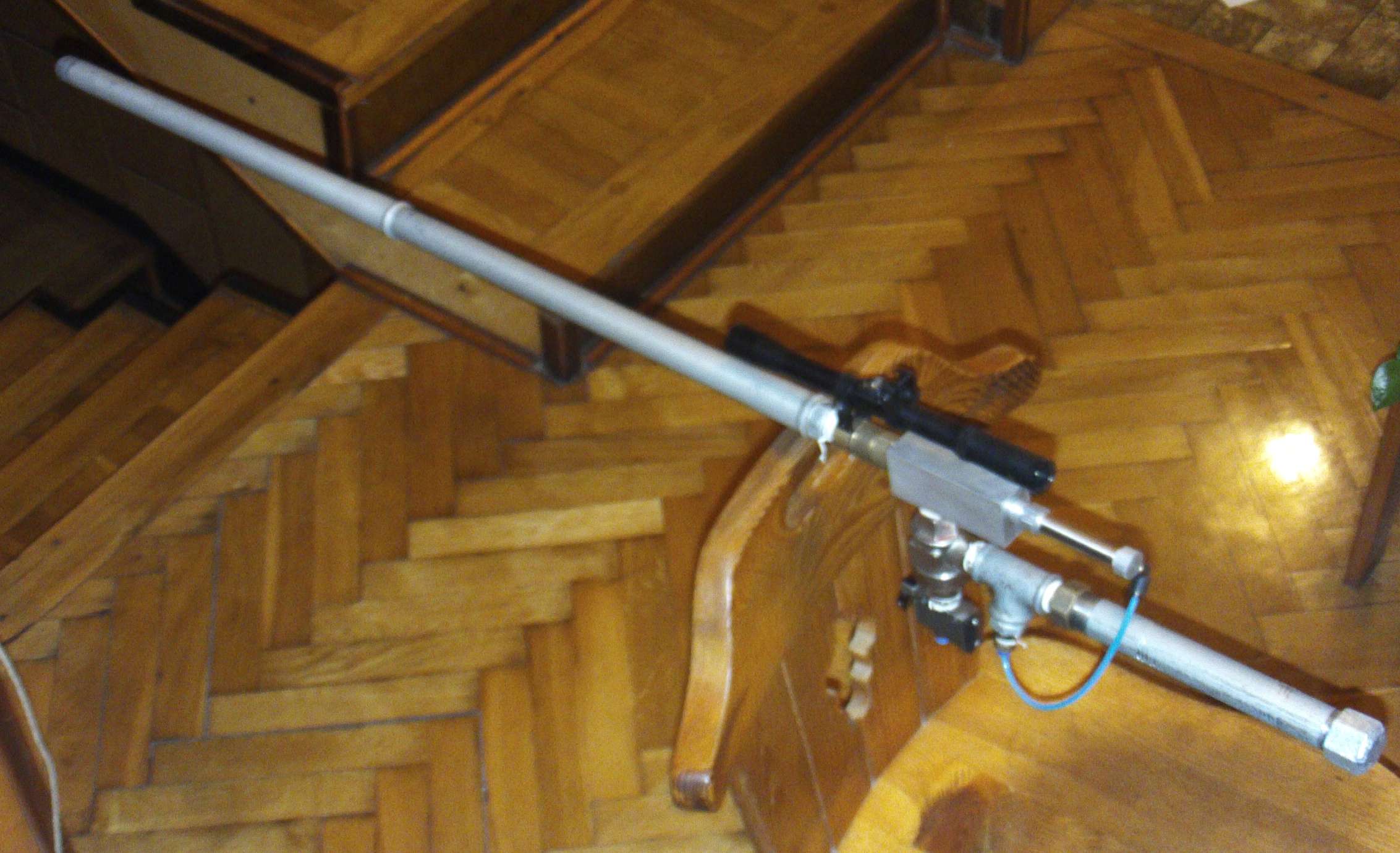

This version uses 8.731 mm steel BBs as ammo as they are relatively cheap when compared with, for example 12.7mm steel BBs

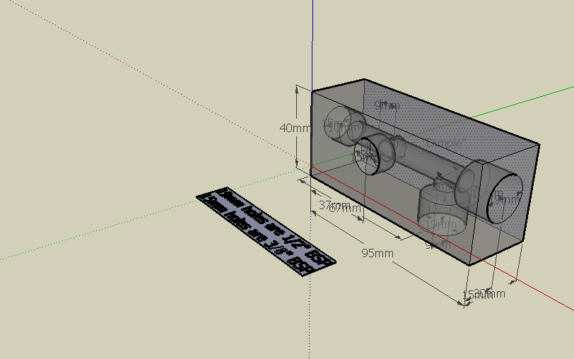

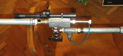

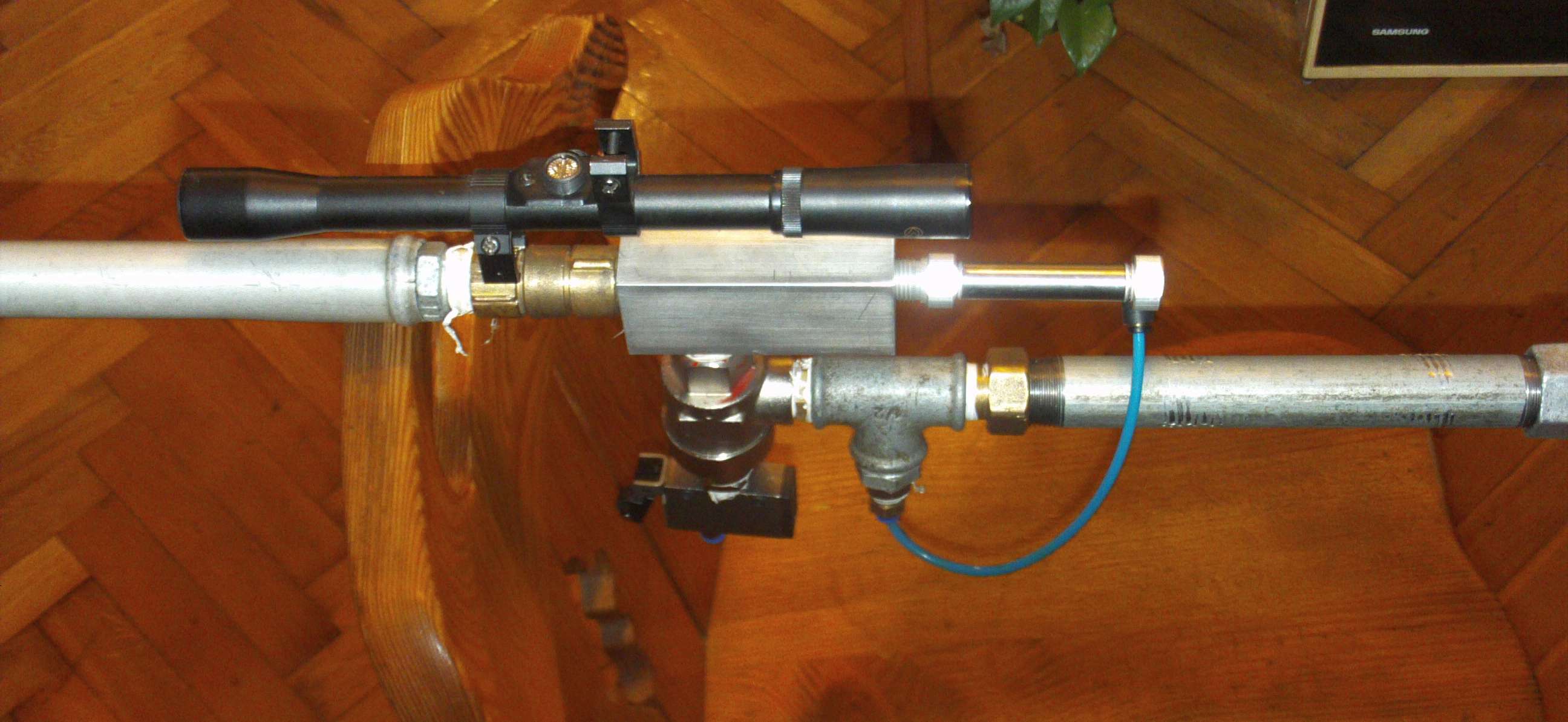

The best thing introduced in this version this gun is the aluminium block/T that psycix machined for me. I really consider this to be a great leap forward as far as reliability and compactness are concerned
barrel - 100 cm 9mm ID hydraulic tubing
chamber - 20cm X 3/4" galvanised malleable iron + miscellaneous fittings
main valve - 1/2" QEV
pilot valve - mechanically actuated 3 way valve (bosch rexroth 0820402002 linky
the spool and the housing are so precisely machined they create a perfect seal with lubricated air)
scope - cheapo 4X20
total mass of the gun (with a vertical grip scope, mag and a 1/8" QEV to assist piloting) - 2.8kg
Right now it has a gravity fed mag/hopper (not included in these pics). I've ordered a suitable spring but it hasn't arrived yet

- I used sketchup to design the T. lol I know it's not used for it but it made designing much easier

Wow where did you get that neatly machined block to house the loading system?
Oh wait I remember....
Anyways: nicely done Poland, this loading mechanism seems very reliable and I'm sure you will inspire other people to use it as well.

it has a silencer that should help with that... I wasn't using any sights in the first vid (80 metres) so I guess it is quite accurate..have you considered porting the barrel to help with accuracy
right now I am limited to short range shots as everything is covered in knee deep snow and I've got some work to do
sorry I forgot to mention that it's not included in the pic. It's just a vertical aluminium tube. Its ammo capacity is about 20 roundsWhere is the magazine ?
yes, it uses external air supply (fridge compressor with a 10L tank). But I am considering using one of those 88g co2 cartridge to power it...Is the gun using an external air supply

thx again for machining it.
But just to clarify this...
It's not that you need a machined block to build a gun like this. If you are lucky you might find these or you can just use standard fittings (though you'd have to sleeve the inside with a small tube)
